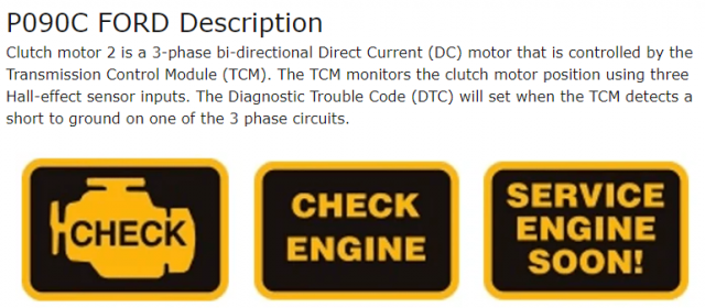

Ok, so you may not be the best at cars, but this tells me you have a potentially big electrical problem that could damage the powertrain.
Hall effect devices are simple field proximity switches, they work like a switch; off when not exposed to a magnetic field - turn on when exposed, and if left exposed - will "neutralize" or switch off until the field is removed then switch back on erratically during that transition. They have a memory effect especially when they get coated in debris as small as metal filings and shards that have or are (exposed to get) magnetized themselves - they tend to stick to the metal mount of the sensor - lowering/lessening the ability to sense changes they need to - in order to work to correctly time the shift points.
GM HEI stuff from years ago had a similar problem with Reluctor to Sensor - a stationary sensor housed surrounding a moving coil - similar to an Alternators stator and Rotor - a simple air gap can get clogged by metal shards and cause intermittent to eventual failure of the pickup coil to even fire the spark plugs. It didn't fail itself, it just can sense the change in the field thru the air gap that gets clogged with debris.
I know, you're not "into" the tech of cars, but it looks to me that the devices used in the shift housing that contains the transmission and clutch - for that year, needs some work. The clutch and gear train in the area can "grind" or wear, causing small shards to appear and due to their size and weight - fly about and ricochet inside the housing - even getting lodged into the wiring harness and or mounts these devices use to maintain their firm distance for gap and to reduce vibration. Even then - a loose mounting can also cause this failure because the device itself can sense the vibration as a change in the "stationary" field around it. (the Hall effect device moves within it causing the error to appear)
Since you're telling us the condition seems to be getting worse, the only help I can provide is to brace for a large bill for the labor cost and teardown and reassembly is time consuming. There is an ongoing litigation suit for repair and if this failure is part of the conditions of the lawsuit - you may get a break off the cost of the repair.
