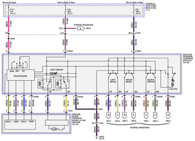

This is the best I can do to help...for USA Models - hope some of this can apply to you - just the Drivers side is on the Right.
The Main Door "Drivers Side" has all the biggie stuff to make the windows operate thru a master - each window is powered thru the master - in parallel. So each window operates independently - but gets power to do that thru the MASTER.

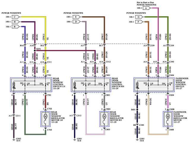

Please note that the Passenger side front window - being powered by the same fuse the Drivers window is (F34 in above diagram), Rear windows are powered by fuse F31.

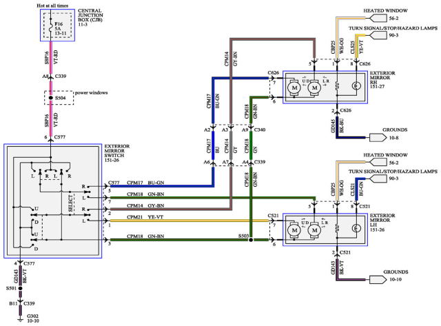

Mirrors are a different story...

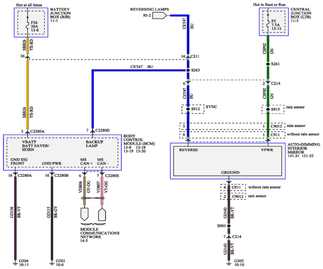

And if you have the "Auto Dimming" mirror option...
