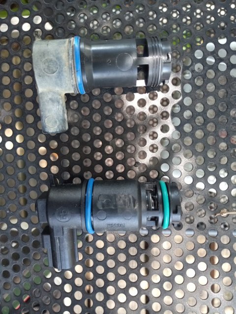

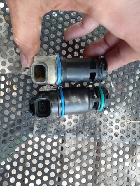

Seem it was as I feared ,not all 2011 Have a vapor/charcoal canister removable solenoid some are built into it.

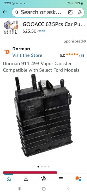

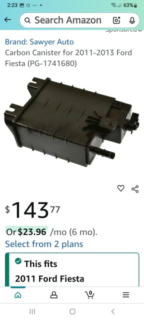

Low and behold here is the proof ,if you carefully look both canisters are for Fiesta but not interchangeable.
Any one that comes into my same problem now you know why you may not be able to find it. I LOOK everywhere under the hood took intake out,went under the car and even remove the RL wheel and fender to No avail ,then finally decided to turn the piece that most resemble and there is was a dummy plug, literally does,nothing as is sealed on the elbow ,and when you check the hole on the Canister is just that a hole πŸ˜…πŸ€·πŸ»β€β™‚οΈ
