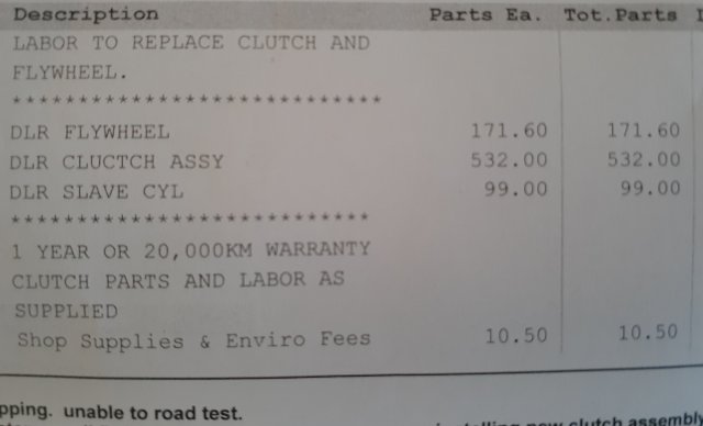

Clutch situation update: *all prices will be in CAD*
Dropped off the car at a reputable transmission shop yesterday and got the quote today. Original estimate was $1848.72 tax-in for an aftermarket Luk clutch kit ($619.80) and flywheel resurface ($120). We looked into OEM parts and found a Ford flywheel in Edmonton for $171.60 and Ford clutch kit in Ontario for $532 minus slave cylinder, which the shop says they can likely reuse my original. They ordered an OEM slave cylinder for $100 just in case and will only be charged if it's needed. Total for the work is $1807.23 for everything (6.9 hours labor). I'm still miffed as to why the clutch failed at only 85k kilometers on the car. I'm no Senna, but I know how to drive and have never had an issue like this with any other manual car I've ever owned. Is this estimate reasonable?

You actually got off easy - seen estimates closer to $3K in parts and labor with the transmission being rebuilt - about $2K in cost alone.
Hope the LUK clutch works out for you. Glad to know they have it for your Fiesta.
The resurface of the flywheel is interesting - this tells me the media did a lot of damage - but was it from lack of use (rusted flywheel) or the media itself getting contaminated with fluid (Brake from hydraulic clutch) or oil seal either from the tranny side or otherwise.
But also raises questions of someone hot-dogging it - but that would also show up as other concerns like radiator and coolant - it would have a lot of air trapped in the motor - you'd see it as bubbles and foaming at the coolant tank when you unscrewed the cap when it's warmed up but not too hot - onto you'd hear the water pump struggle with bearing noises and belt squeal if it got too dry where the fluid got too foamed up or cavitated lowering the coolant level below an effective level to push fluid thru.

What do you mean by hot-dogging it? Car was tested by the shop but doubt anything was taken apart before ordering any of the parts. We're getting an OEM Ford clutch kit for about $90 less than the aftermarket Luk clutch, although it doesn't come with the slave cylinder. Resurfacing the flywheel was the original idea before we found a brand new one for $50 more so went with that instead. The car drove perfectly fine when we parked it last, and started slipping the very next morning. I suspected a leak at first so put a big piece of cardboard under it and didn't see a drop of fluid for a solid week. My best guess now is a broken release spring? Brake fluid was at the full level too

They are replacing the flywheel and complete clutch kit while reusing the original slave cylinder

Got the car back. They had to use a new slave cylinder and even threw in a complimentary p0301 code. Also the rear shocks are leaking. Fun.
Ride home seemed fine. Deleted the code. Will see if it comes back
