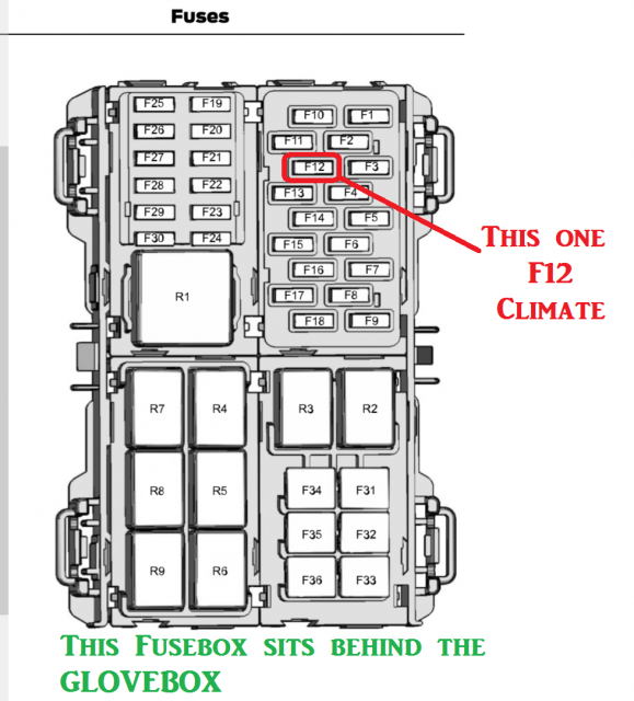

      • Fuses located in the internal Passenger compartment fuse block can also have fuses affecting the blower

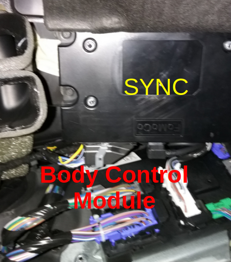

Ok, back to the BCM.
It's located on the firewall in the passenger compartment - right by the Cabin Air Cleaner and the Recirculated and Outside air - door assembly.
The BCM handles Fuel pressure so it uses a relay in earlier models and in the latter ones, they switched to Solid State modules - to handle the Fuel pump and pressure regulation demands.
Those earlier ones had relays that carried their mechanical apparatus noise (transferred it) into the car by having that box with all those connectors sealed with those relays inside it - clicking away as you idle thru the moments in time when the Fuel pressure in the fuel rail was at a maintain point that made those relays click more or less in a 2~3 second pause as time passed - slowly - making matters worse was those times when you're running silent and the clicks seems to turn more into a clackitty clack
The photo above is what you'd see when you go under the Glovebox - you see this when you look up from the floorboard - the BCM is BOLTED to the firewall and can be a source of this noise.
You can verfiy that click-click is from here, by placing your hand on the module as the engine runs and you can feel the relay click vibrate into your hand from the module - if this is where that sound seems to be coming from, don't worry, it's normal.
