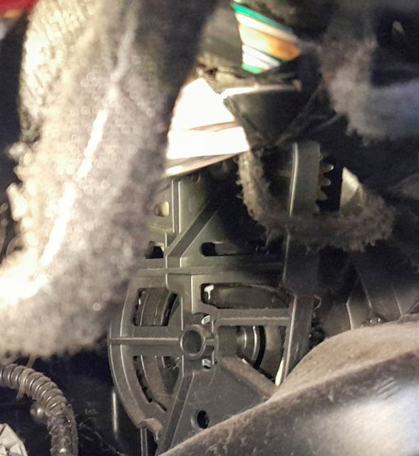

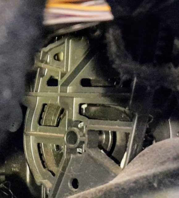

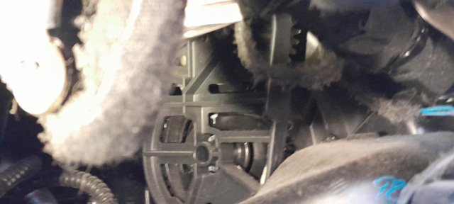

Ok so I found it, now what would be the best way to get access to the driver side blend door actuator here are the pictures. Any help would be grateful 20230927_165557~2.jpg 20230927_165605~3.jpg 20230927_165554.jpg 20230927_165557~2.jpg 20230927_165605~3.jpg 20230927_165554.jpg 20230927_165557~2.jpg 20230927_165605~3.jpg 20230927_165554.jpg

You'll need to remove the lower kick panel and the side rail trim of the Driver's side and use a "stubby" T20/T15 Torx bit to loosen three screws that hold the actuator to the gear of the drum so the drum turns as the gear moves.

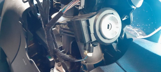

The kick panel has a Air bag so remember to remove the panel and carefully pull the pinch clip off the igniter so you can cleanly work in and around the steering column.
The side panel (the one at the console) needs to be removed so you can retrieve any loose screws - at least place a sheet of paper under the ventilation assembly and where the carpet meets it at - so that if you do lose a screw - it doesn't roll under the carpet.
There is a Yellow/Green/Red color "tab" on the motors power connector - might want to pull that tab - lift it up so to the connector tab can then get pinched and pulled out of the connector so to save it from getting whacked by trying to remove the 3 screws.
Once the three screws are out, the motor can get pulled straight away from the housing and will expose the gear mesh.
So take your finger and move the drum gear to see if it's obstructed - it can happen and most of the time the debris is caught in the drum to a vent hole - which then you'll have to remove the outlet plumbing of the affected vent or the whole assembly to free up the mechanism.
The video tells the rest of the story.

That seems doable. Like i said i found it. But its located in a very tough spot. I guess I'm really more worried about the airbag sensitivity. I just started really getting into working on my own car. So those type of things make me a little worried and less confident that I can do it..

If you disconnect your negative battery terminal, you remove the power from the systems in the car. That is the first way to ensure safety for both the person working and the electrical system in the car.
There is a number of systems that will need to be activated to cause the airbag(s) to deploy. Generally short of physically powering the airbag unit directly an airbag will not go off spontaneously ( I say "generally" only because there is that one story about that one time one bag went off unprevoked, lol).
There needs to be a few modes the car must checkmark in order for the system to be ready to activate. These can include speeds above a threshold, rate of acceleration/deceleration, some cars also will read attitude/angle (such as roll over). There are failsafes, such as deployment sensors where 2 or more sensors need to be tripped for the bags to be deployed.
I wouldn't be afraid to work on the car provided you keep to working on the system you are intending to, and if it looks weird, just ask.
