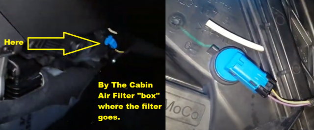

With the Cabin air filter, the only thing that could go wrong is the disconnect of a sensor that has that Climate control blow air on it to sense temperature - if it's been disconnected or wires been pinched - it could explain what is going on.
Its in the area where you have to remove those cover screws and pull out old - insert new filter - so might not be a bad idea to look over the work.

Thanks very much, I'm sure that's the problem. I appreciate your help!
