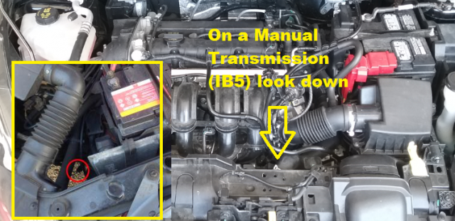

Where is the reversing light switch on the 2015 ws or wz model auto hatchback is it under the battery?

Transmission Housing - located on the iB5 transmission - front side, by radiator shroud - right next (behind) Fan Motor - little black connector.
Automatic? Buried in the AT itself usually by the shifter cable entry.
