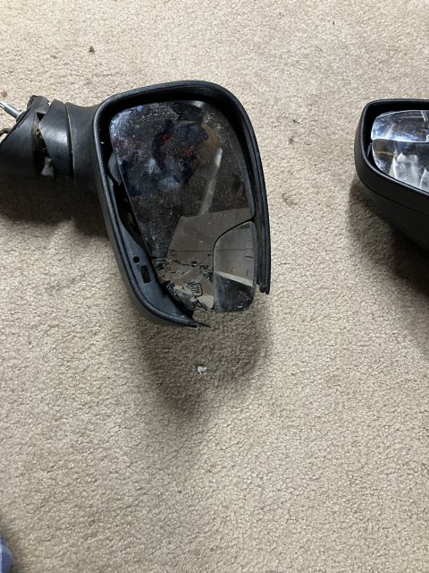

Has anyone every disassembled the whole mirror assembly?
I'm trying to repair a fully functioning mirror and can source the bottom plastic as such:
As well as the indicator, plastic frame and cover to repair the full mirror instead of replacing the whole thing.
My question is, how hard is it to split the lower part apart to be able to replace that bottom piece of plastic, has anyone done it?
Thanks
The lower part - as you can see in your supplied photo - uses a press nut to keep tension on a spring with a detent to "set" the mirror in it's extended outward position, then the mirror (upper portion) can then be twisted towards the car to slim down the parked profile and protect the mirror from breakage.
So you (we know this) but the problem lies in the press nut and fashioning another to fit and yet hold the spring tension to keep the mirror from popping off.
The shaft - from my understanding - is a "one shot" deal and many scraps are produced in production to show just to tricky that press nut, and to make the "square it on the shaft", is to it. For if the nut is not square (perpendicular) to the shaft - the vibration and rotation of the swing arm it works as, will back out that nut and or dig the splines of the nut loose and the mirror shakes and vibrates and becomes an epic fail.
It may be better to just replace the mirror assembly with another one or a newer one for the removing of the spline and nut itself - that original pressing is more a permanent positioning that is hard to re-establish.
The reason why I mention that is the one piece that you show is part of the install of the OEM spline and nut "smash" that puts the assembly (presses the upper arm to the spring and its seat) together - that if only the skullcap was broken that is bad enough - but the shaft assembly and that bottom support - too much to lose there in realignment and pressing it back to refit.
+1 on what Andy said. I looked at salvaging a few pieces of mirrors from damaged Fiesta’s I have purchased. Other than being able to pop off a couple of mirror faces, they were all toast.
When the pivot bolts are broken loose, it’s the equivalent of having a broken spine.
The guts of the assembly may still have some useful parts. Drive motor and mirror face being most valuable.
