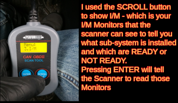

So, when you get that little code scanner, look not just for codes, but the I/M monitors - see which system the OBD can monitor, is NOT READY that is a sub-system to check, like EVAP EGR, PCM FUEL HVAC and others - depends on the model of scanner you use.
