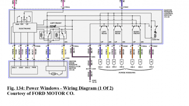

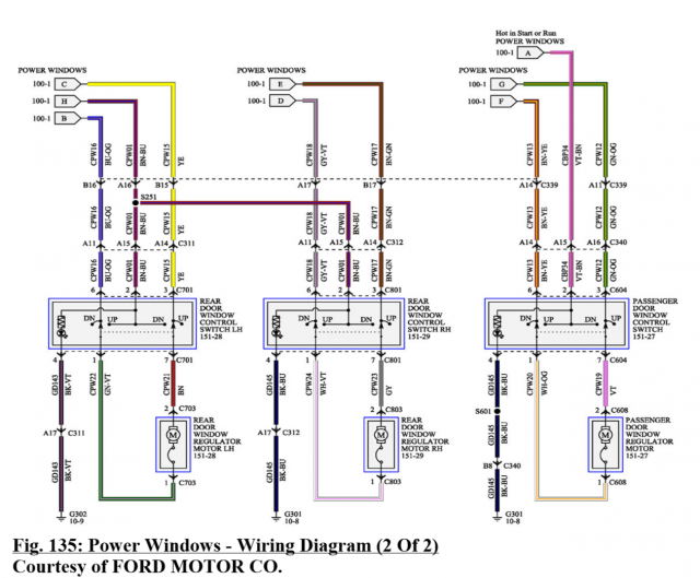

The wiring to the motor only has two wires, so it (the switch) REVERSES polarity to make the motor change direction.
So it may be back at the MASTER SWITCH that the wiring to that rear door is from - is suspect.
