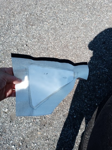

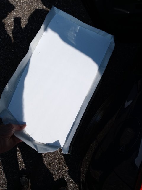

I traced the inside perimeter of the rear side windows onto a sheet of newsprint. Cut the template out and laid it on a sheet of quarter inch thick foam board from the dollar store. Cutting very slightly under the line that i traced.

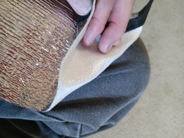

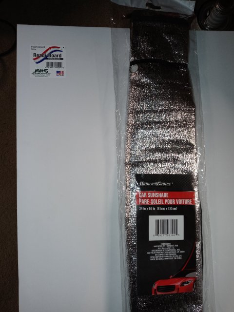

Then i took a dollar store reflective foil and foam windshield sunscreen and placed it face down on the foam side of the sunscreen.

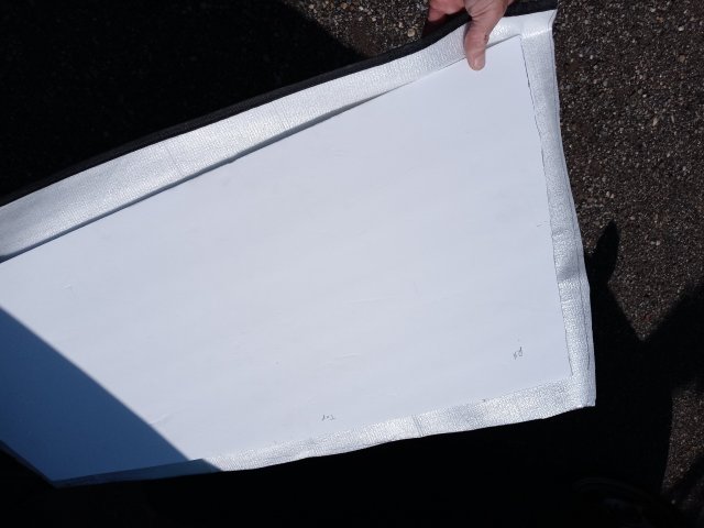

Then i over 20210920_192723.jpg cut around the sunscreen by about 1.5 inches. Once I had it trimmed, i marked the position of the panel on the reflective sheet with a sharpie pen to ease positioning when i sprayed on the adhesive.
I let the spray adhesive set for about 15 minutes before I pressed it onto the foam board.

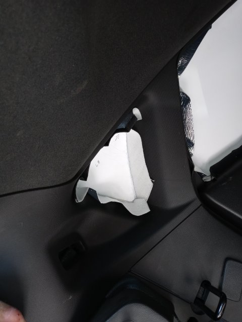

These panels are an interference fit into the window frames and don't need any retainers or tape to stay in place.
When i want to remove them i just gently pull on the extra margin of material.

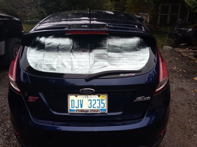

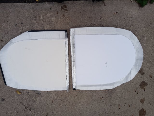

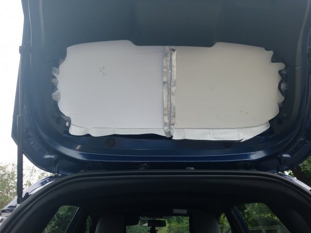

I finally got both time and clear enough weather to start fitting the sun blocking/ privacy panels for the hatch back window.
Divided vertically in the middle, these look like they will be a simple "press fit".
Still have some edge trimming and gluing to call it done. But this is 90% completed!
The rear glass being curved causes these panels to not fit flush to the glass. But, it still fully blocks daylight and also stays in place even when i slam the hatch lid shut. Which is as severe a test of secure fit as i can think of.
