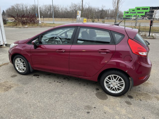

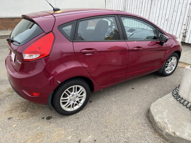

Thank you to Scotman and Handy Andy for the information. You helped me to choose a non-steel rim for my winter tires. I've attached these photos in case anyone might want to do the same thing. These rims are off of a 2010 Focus. IMG_7052.jpg IMG_7053.jpg

There ya go!
Looks good! Don't know why they didn't keep these around for the Fiestas' they do "upgrade" the look!
