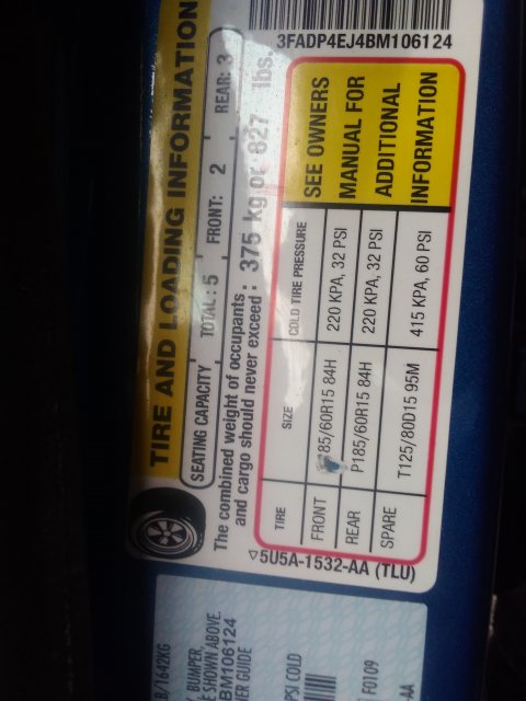

a 15 will fit, your pare tire is 15x60x185 at 47.5mm offset and rim is 6" wide

I checked with a local tire shop in my region for 15" rims for winter and they recommended that I put 185/60R15 tires. I asked them if I could fit my old car's winter tires, which were 195/60R15. They asked me to verify with my dealer because that difference could void my warranty. Anybody ever heard of this?
