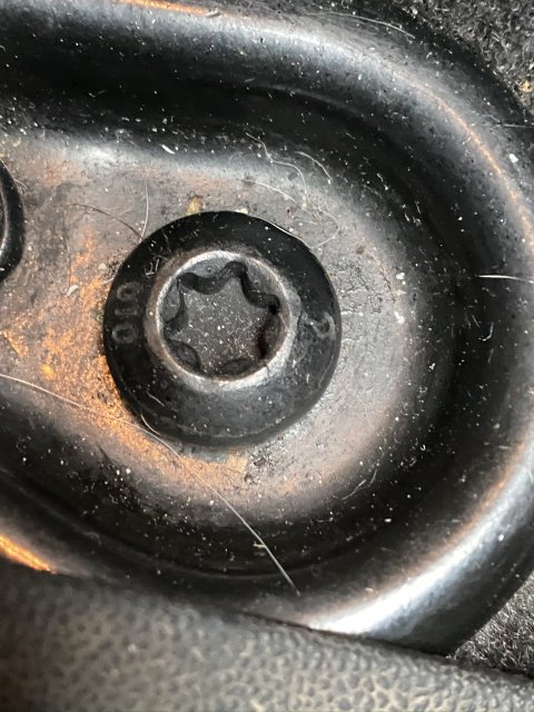

I'm looking to pull the seats out of my 2013 Ford Fiesta, but I am not sure what attachment for my impact driver to order? I believe need a "Head Bolt" attachment, but honestly this is brand new territory for me. I'll include an image, but from what I can make out the number on the bolt is 010. Thanks for the help! In the midst of quarantine I think this would be a great project!

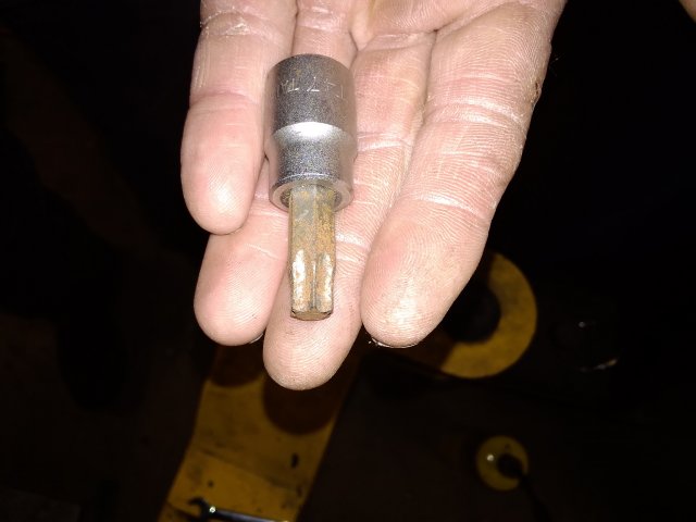

T-47 I believe. Have a can of WD-40 near! Carefully apply torque to break it loose and Then hit it with a shot of penetrating oil at the base! Let it sit for a few minutes. Then carefully start to back it out. Main goal here is to NOT strip the contact points of the torx bolt! So, Don't whack it with an impact wrench! You will very likely simultaneously break the Torx bit and strip the contact points of the bolt. IMG_20200323_134702.jpg
