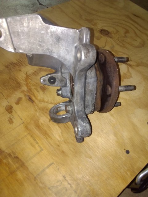

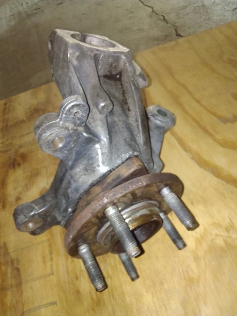

MBP is correct on the direction to go! I have found that the 1996 to 2004 Taurus and Sable have slightly larger bearings (Bolt in type) and are a lot lighter, being an aluminum component, except for the bearing/hub. I suspect that it's forged or some kind of hi tech pressure casting! But, Again you have a lot of research to do. What you want is not an off the shelf or kit build kind of thing.
I attached two pics of a 96 to 98 Taurus knuckle. It's super light, bolt in hub/bearing and has an appropriate size lower ball joint for either a heavy or very powerful car.

Nice, didn't know those were bolt-on hubs! Yea, to get those to work you better know or be a great fabricator.
