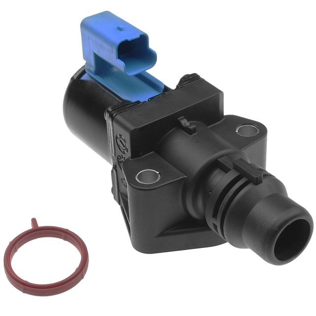

The next possible cause could be the heater control valve has failed. It's not a hugely expensive part to replace. I am uncertain if later mk7 Fiesta had this component across the range or not. s-l1600.jpg
