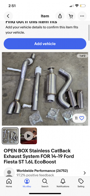

OK! After frustrating research I did it. Bought a ST exhaust for my SE. It fits after a lot of hassle with the exhaust flange studs. Hangs a little low over the brace after the resonator, but doesn’t seem to rattle. And you need a longer hanger for the rear or cut your bumper. THIS EXHAUST SOUNDS AWFUL. All drone at anything over idle. Pretty much sounds like you’re directly next to a helicopter. Would not recommend this to anyone with an SE. If you have an SE, don’t buy a catback like this, you’ll regret it unless you add a muffler to it, and it seems hard to find one that will fit. Hopefully I saved somehow a massive headache.

Did you get the pipes that route to the middle back or still more "stock" off to the right rear as a usual SE would?

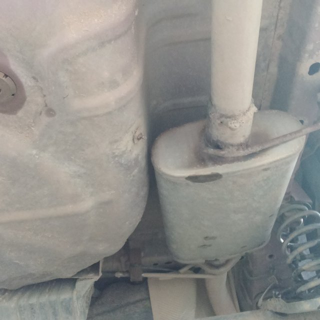

That sucks ,and is not like cat back for these cars are cheap neither ,mine is a J2 engineering that I bought on sale for less than 300, the only issue was the muffler didn't came quite out of flush with bumper like it would on a Hatchback ,I didn't care.
But when the muffler broke, after almost 3 years ,I fixed it with a Magnaflow and a 12 inch extension and reuse the tail pipe ,the only thing I wish I done differently was have him weld the outside diameter and not inside, after 3 months and getting On it ,it broke one of the weld points and have yet to get it fixed xD ,is not loud so i haven't really cared ,they guy even said he Re do it free
Some this things need to happen so we can learn some more 😪
