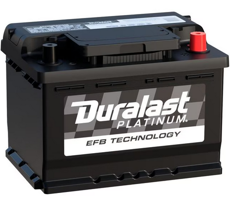

Best to simply measure the battery you currently have in that battery box and just reference the fitment chart - it would have a cross reference size or type (a code of letters and numbers) like 49R or 36RS-AGM.
In our case of the Fiesta
The Battery case is...

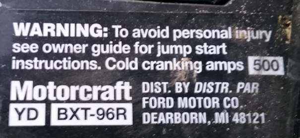

Here, in the USA - the OEM battery in the Ford Fiesta is a Motorcraft with a case size of 96R - meaning that if you were looking at the Front of the Battery on a table - the Positive post would be on your Right. And has a good amperage capacity - at least it's capable of 590CCA.
Now in your country - that might be different. So it would be wise to verify this case size and style of terminals with a local dealer - just to be sure.
(In the Above notes...)
  • The OEM is a BXT-96R but note the CCA rating is 500.
  • With this in mind, the 96R factor is of the size of that case - and you can get batteries of higher or larger capacity ratings of up to 600CCA but needs to meet this sizing - so use discretion.
