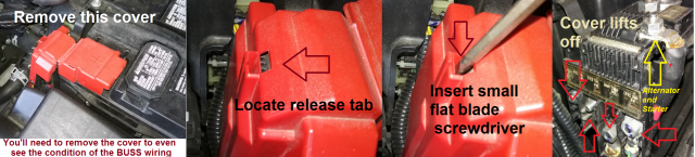

Double check your Positive terminal Red cap and all the bolts in it - that red plastic cover comes off.
Make sure you have all your bolts on that Battery Junction Box tight and the Fuses in it, are not blown.
The above is from a 2018 - your battery junction box may be different.
So look at this post about a 2012 Fiesta - before it got a Nose Job...
