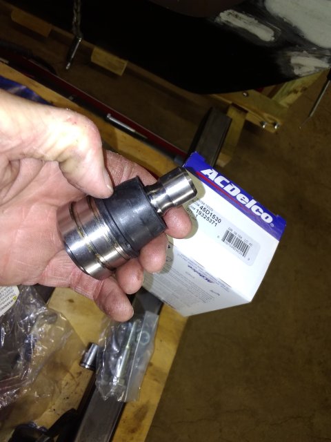

I knocked out the ball joints with a hammer and a block of wood. The Delco ball joints I bought had the circlip retaining clips and they worked perfectly fine. I think the Delco part number was 45D1530. IMG_20200911_165518.jpg
