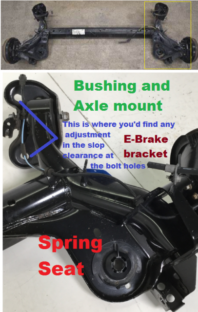

The "natural caster" angle for the Fiesta - about 7 degrees Positive - Being at rest and both Front and Rear axles level
There is NO Front toe-in or out.(±0 angle) However Rear Axle Toe in-out may vary by as much a 0.5 ± degrees due to loading - related to ride height - for rear CAMBER is preset and not adjustable per Ford's way of doing things, but that does not mean it's impossible...

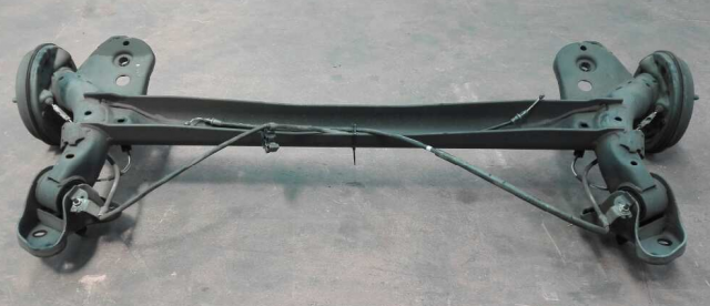

The rear Axle is shaped a lot like a Wishbone and has two pivot points on the frame,
in the axis line of the Front to Rear frame.
Two bushings, and their bolted connection point to the Frame truly - no adjustment,
- you have to rely on the SLOP of the bolt to hole bushing clearance in order to affect any effort
to change your "thrust angle"​

What you see from the bottom, note the rear bushing mounts are in the front of this view.
