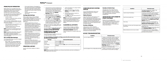

The MY Key - or the original - can be made Administration - by allowing ANOTHER key - being an unprogrammed Key (Read not set as MY key - you'll see them in your Menu display as Administration Keys - those keys becomes your new lease on the vehicle) You have to tell the system the old key is the My Key, then the old key is used to start first, then you turn off, then insert the new "fresh" Admin key to help the system see the new key. The Proceedure for that step is located on Page 58 of the Owners manual.
I looked up the 2015 My Key process for your vehicle - starts on Page 47 in your Owners manual - since you have time now, you may want to spend some time going over what the MY Key and the Administration Keys and see if the Administration Keys can start the car then you can clear all the keys and My Key original too - and start over.
Heres' what I got...
1,883
1,345

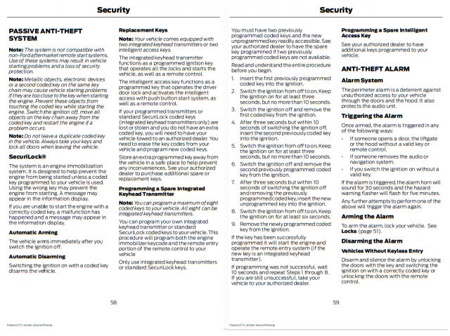

2nd half - when you go looking for that PATS system, locate Page 58 on your manual
1,883
1,345
After the MASTER Relearn procedure from @scotman - you should be able to get at least one of the new keys to be recognized as an Admin key.
Then you can help the system relearn the other keys. The Procedure is above.

However the PATS instructions present an issue. The instructions start with "You must have two previously programmed coded keys and the new unprogrammed key readily accessible." This is the issue that prevented me from following those instructions to begin with and the reason I went to the dealership to sort this out. I only have one key.

This is not going to be possible for me to do on my own. Everything I'm reading indicates that I need 1) an admin key to clear the MyKey and 2) both keys to program a new one.
First, the reset procedure had no effect at all. I disconnected the battery, put the key in and turned it to the first position and re-connected the battery. The Sync system said "Performing scheduled maintenance" then started up as usual. The MyKey is still active.
After that I tried following the instructions in the manual to clear MyKeys from the system:
CLEARING ALL MYKEYS
You can clear or change your MyKey settings using the information display control on the steering wheel. See Information Displays (page 83).
Switch the ignition on using an admin key or fob.
To clear all MyKeys of all MyKey settings, press the left arrow button to access the main menu and scroll to:
Message/Action and Description
Settings/Press the OK button.
MyKey/Press the OK button.
Clear MyKey/Press and hold the OK button until the following message displays.
All MyKeys Cleared
The only key I have is not an admin key. Also, the instructions reference buttons I don't have in my car. The only way I can interact with the MyKey stuff is by starting the car. At that point I can get to a MyKey menu in the Sync system but all I can do is view the status. there's no "Clear MyKey" button.

So moving on to the topic of programming new keys, I have a similar problem. The instructions starting on page 59 state:
unprogrammed key readily accessible. See
your authorized dealer to have the spare
key programmed if two previously
programmed coded keys are not available.
Again, I only have one key.
