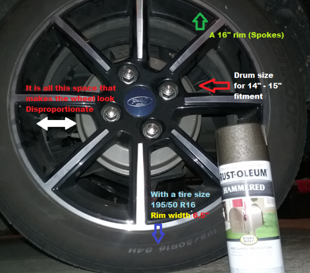

Ok, you mentioned you have 15 - steels and wish to go to a lighter 16" wheel - yes, I too have those 16" in "spokes" but to be honest that lighter weight wheel has drawbacks with the feel of the road versus what others might like as a firmness the steelies provide in feel of a weighted effect that those heavier rims provide when it comes to road vibration and harmonics that can arise from the pavement and the tire "singing" due to the freeplay in the bearings, T-rods and suspension that the stiffer shocks might not be able to tame, making certain trips on certain roads a tiresome endeavor that would make some wish they have taken a graveled road for a sense of real fatigue versus the effort of keeping it between the lines on a smooth surface just to prevent the numbness that singing harmonics can do to someone's physique.
You can also look for posts like from @scotman or @econoboxrocks or @manbearpig and @SyntheticAtmosphere and @LionsTooth (If I forgot anyone forgive me - you really should be helping this guy along you know...[welcome]) Along with topics you just mentioned - Tires and Suspension - you'll find the posters above putting in their comments and adding to the knowledge base to help speed your efforts along...
Ok, we talked about the spokes for a reason, when you swap out those 15" to a larger diameter rim size, the proportions of the "Wheel to Brake and Hub" effects become pronounced. As in - the Drums, or Rotors - their diameter and design clearance size was "pre-set" to fit into a 14" to 15" rim and yet look beefy enough to be a working mechanism in the styling of the cars agility - but overdoing the Rim size opens the space - maybe too much - kinda' looks goofy, like you are waiting to find someone to advertise in the spokes of the wheels to help provide some income while your drive the city streets.
Hey, remember to do a search because we post a lot of pics to help others find their way in all of this - in more ways than one. So to look at a new rim with "spokes" would be of a set of posts regarding rusty drums and how they make a car look - er, bad - not a true performance hit but it brings up the realm of Rim size to wheel and the level of space you'll have to cover with - whatever floats your boat.
