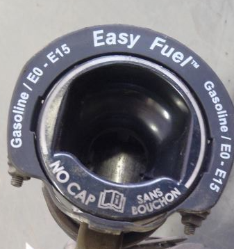

To help further, this could even be as simple as a leak in the fuel nozzle they use for the "no cap".
It is a two piece unit and a seal is sandwiched between the two - it can even generate a vacuum leak so the system thinks something is seriously wrong (at least enough to tell you some other conveniences like Hill Assist) and disable some secondary functions you normally don't deal with.
In order to even be mounted it uses a grommet - you can figure that in some instances that grommet will develop a leak and there goes the seal - setting a check engine light and some silly code you can't track down because it doesn't know what to do.
