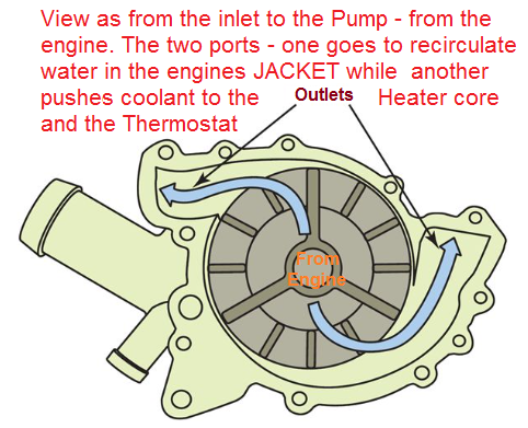

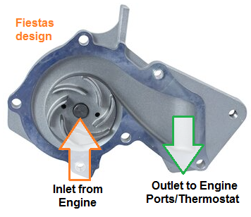

The Fiesta pump is similar but has only 2 ports; an Inlet, to the impeller - then the outlet to the jacket. The jacket is sealed within the cast block but has passages thru it to pass coolant around the cylinders to cool them. The flow is pretty brisk even at idle and most of the heat is pressed back into the motor - but also flows by and around the housing that contains the Thermostat and the Heater Hose OUTLET of hot coolant to the Heater core - the return hose arrives to the engine and is part of the INLET port.
So you have a two-fold failure in progress here from what I read, all the steps you've done aside from the second replacement radiator and a new flush to VERIFY the water pump in there - can pump fluid thru the system. You have to make sure the pump is pushing coolant into and thru the motor, and it is sound enough to continue working - for when you're at idle - the issue of those enlarged ports and debris shows up as bubbling and that means; no coolant - or not enough coolant - is moving thru the system at idle speeds - boiling the coolant because it can't pull enough heat out of the engine to the radiator.

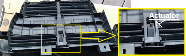

But I wanted to also ask you if you checked the front inlet grille of the car, when the engines off, does the front have what they would call shutters?
  • - as in these vanes like a venetian blind
  • - would close when the engine is cold or off
  • - as a means to provide efficiency in keeping heat from the motor in there for faster warming up and holding the heat so the engine doesn't have to "idle up" it's mixture as possible to save money in gas used to offset a colder than normal operating temperature motor.
There is supposed to be a thermostat that monitors that and moves an actuator tied to those shutters.
