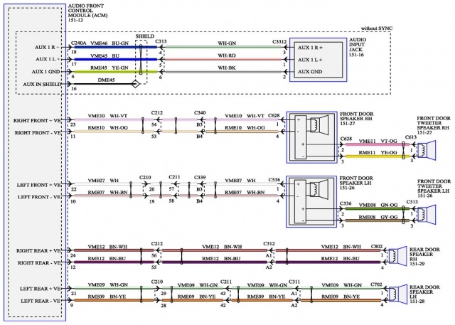

1739058156612.png The Door speakers and the pillar tweeter (Armrest on the top sill of the door) , use a Crossover as a band-pass filter - letting the lower tones pass into the door speaker, while the higher mid-range and upper treble range go to the tweeter - so if you "wire" directly to the speakers as a pair, the Ohmic result might make that amp refuse to drive that type of connection for the ohmic level is too low for it to work safely without damage to the speakers or the radio.
So if you changed the door speaker yet kept the tweeter ones, that might make the Speakers Impedance the radio sees, too low
