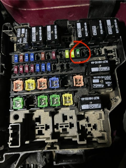

I had the fuse panel under the hood open and found a melted 30A fuse. I found a fuse block schematic that indicates that slot is for the rear defrost. I must have picked a bad schematic because my rear defrost works. I’ve also never seen a Ford circuit protected by a 30A fuse, so I’m guessing a previous owner must have been messing around with something they don’t understand.
My car was being pulled by a motorhome in the past, so they might have run the wiring for the lights through the fuse block. Does anyone else think that is what this fuse slot was being used for? IMG_7459.jpeg

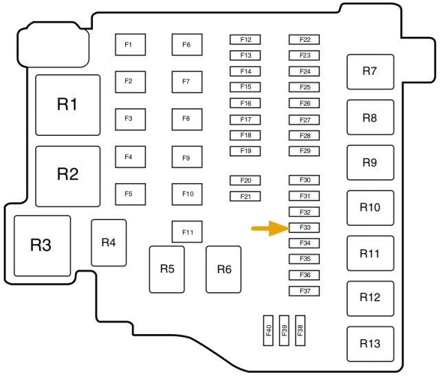

This is interesting, for it is Rear window Defrost, but also from the BCM.
Didn't know if you could have checked (before and after) that when you start the engine on a cold day, the Rear defrost will work for several minutes to help remove fog and frost even when you did not select it.
So next time you start it up on a cold day with some frost, leave the F33 out (no defog selected) to see if the rear windshield will clear on it's own.
You don't select rear defog, you let the system use the "Starting Temperature and warm up" routine it uses on cold startups - if it doesn't clear - then put in that fuse - and try it next time when it's cold-enough to develop frost. See if the Fuse is for the BCM to control it automatically on a cold start, versus you selecting it on the Climate control unit instead.

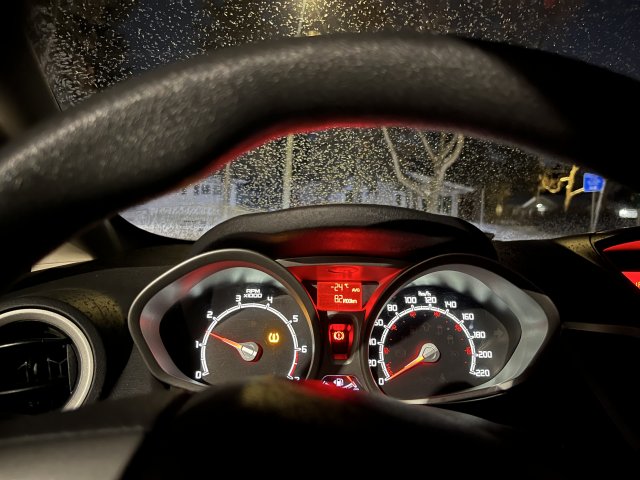

I just finished work and it’s definitely cold enough to test it. -24C. The auto rear defrost is operating as usual. I can see small lines of defining glass on the rear window. The switch to manually activate it is also functional.

Yes, to see it "hot" (burned) like that usually tells me the wiring to it is OK, but the fuse itself was getting warm and it was eventually going to fail. The terminal that has the most current drop - is the one that heats up the most. For one side is always the feeder or Buss side the other side is the load side so considering the mass and amount of metal used, the "hot" side was the line that went to the BCM and since it's smaller can't dissipate the heat as well as a larger contact and buss bar can - so it cooked until it finally blew.
Yes, it needs to be 30A - might want to see if there's corrosion setting in on those contacts for the corrosion itself can make it work like a dropping resistor and generate even more heat, and prevent the heat that is there; from getting pulled away for it would act like a layer of insulation - reducing its ability for thermal heat dissipation.
