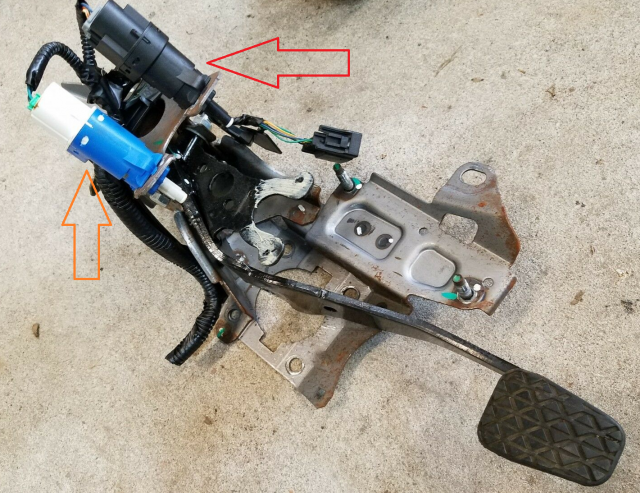

To help you, you will need to look for and possibly observe as you dive your head under the dash - locate the Brake Pedal, there are two switches on a lever towards the front Knee pad just below the steering wheel.
IF those two switches are NOT working right, I can see why you have this issue and then the switches themselves may need some simple adjustment to realign their aspect and let the brake system work separately from the Clutch - for one of the switches handles the Brake Light (rear brake light) the other is a "condition" light that also works but handles Hill Assist and the ability to even "start" the vehicle.

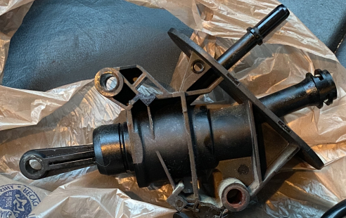

You might want to prepare yourself.
You'll need several things including FRESH brake fluid - mine uses DOT4
While I was trying to investigate, I took some pics of my Fiesta - SE 2018 ...engine compartment.
Found out some stuff that can make you wonder...but then maybe they can help you piece together a plan...
Ok, some orientation...
See that Clutch Piston Bleeder Screw Arrow?
Peer down there, you'll see something like this...
So you'll need to figure out what you have to take off parts and remove the battery and it's tray, push aside the ECM and remove the Air Box, it's hose - so you can have room to bleed down that clutch.
But there is a hose that offshoots from the MASTER Brake Cylinder, it's nylon and routes to the firewall...
So be ready...

I started to write up a separate word or two about others that may have parking brake problems but I'll keep it at the bottom of this post so others can at least see it.
To help with the "hill assist", turn off traction control - it may have triggered the hill assist - but by having wheel spin - even simple spin from takeoff at a light that turns green and your tires slip on the walk markings - mine gets triggered for it. Happens the most of Right turns since they're sharper and when the spin occurs - is where you're car is trying to change directions from one vector to another vector direction - that can make the wheel hop and spin and set the condition.
Not to sound dumb, but I also have triggered my rear wiper arm on causing a condition where it thinks it's raining and makes the skid controls more sensitive. - seem that will also make your headlights come on in the Daytime if you've set your headlights to auto
That's why I'd love to make the Traction control an OFF condition and you turn it on as needed - not the other way around - those right turns to avoid lane traffic and stay centered - the handling is not the problem - the sensors to prevent skids - is.
