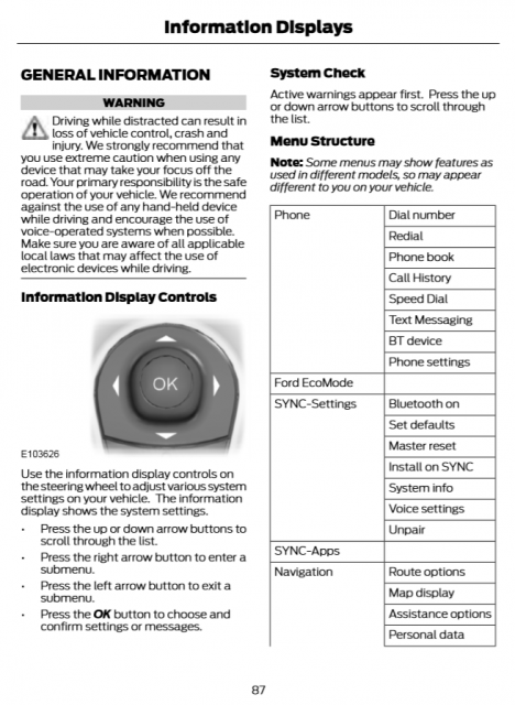

Look in your Manual, start at about Page 87, then while you sit in the car, turn the key to ON, Don't Start it just yet.

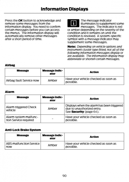

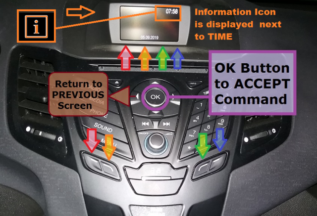

Then look at your console - and also look and get familiar with the "OK" home cursor keyboard - press up or down - Why? Look for a little
INFORMATION ALERT
Symbol in your Main Console Display
Located in upper Right Corner.
Your Console may differ - but will have "OK" button....
Find your Manual - you may have some other more immediate information to look for up to and including Seat Belt and or Engine Malfunctions you may have to scroll past the immediate information to get to.
...start on Page 87...
