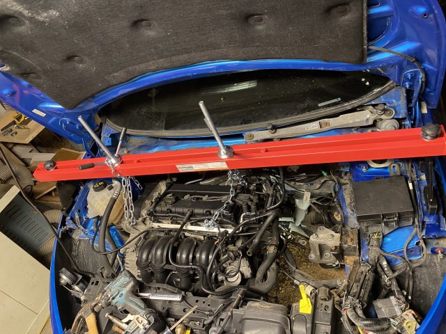

Hello, I recently purchased a 2014 Ford Fiesta Titanium with ~120,000 on a whim and let go of my 2007 Focus with ~220,000. I'm pretty sure the Focus could have made it to 300,000, but suspension was getting a little noisy... After a short time in the Fiesta I was finding it very difficult to shift and now have the car pretty ripped apart in the process of replacing the clutch, slave cylinder, and master cylinder, amongst other numerous parts that look like they might need replacing.

If your shifter lever feels like you're trying to stir concrete, especially after driving for a while, pull the black cover off the box on the lower front of the transmission and remove that bellcrank or walking beam or whatever they call it that the shifter cables are attached to, clean the bore and the metal pin, lube with SilGlyde or similar, and put it back together. I've had to do that a couple of times on my 2012 SE.
