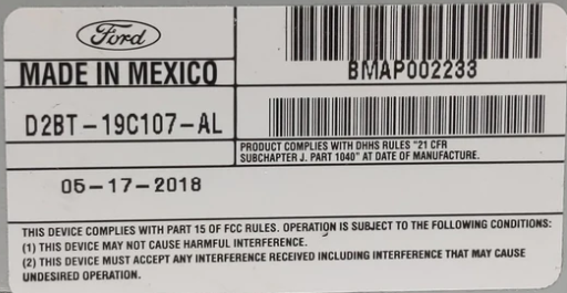

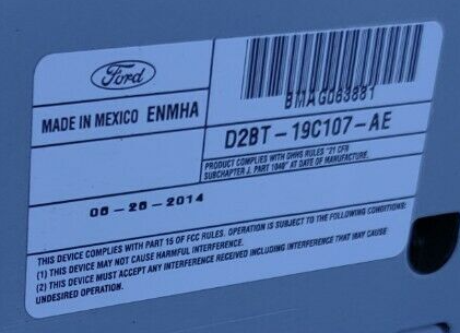

I matched the radio numbers and it all works great. Thank you all. I talked with a guy at the salvage yard yesterday and he told me where I went wrong. I replaced the radio but still not working does the radio model numbers have to be the same? I was fixing the usb port and removed the console and there's a box that says sync there. this car is a pain in my ass. Someone said at ford that my radio may have to be reprogrammed..... not sure if I need it done. Maybe 2nd radio is a dud. Fuses are good.

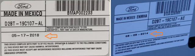

The radios used in various years- like the Fiesta variant numbers like MK6 or MK7 - the old versions of the Ford MFT Audio system - and their newer counterparts are not drop in replacements - the numbers have to match within the year it was made - else the chipset used in the dash radio might not accept the commands the vehicle is telling it.
See the Date code? That is what I'm talking about.
