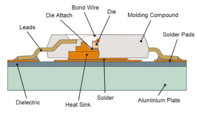

The LED lamps cannot have large swings in power - they use regulated power drivers in their base to control the brightness - they are fixed Lumen emission - so the brightness does not change even when the running voltage drops to nearly 8 volts - then their built in driver circuit will not work (it cuts out) and no light is emitted - it's also why some have to use a FAN to cool the heat sink used to dissipate the power-conversion from voltage drop and regulation losses generated while in use.

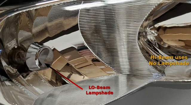

A Typical Tungsten, or Halogen lamp - the filament is the Foci - so the light is made for the curve of the reflector - the depth and centering - so LED - being a point source already, has several things going against it.
One is dispersion - or how wide it can shine a light and be bright to use - the LED's I see use two sided COB chip designs and some means to "frost" or soften it's light which can if not for the lampshade that Halogen uses - would blind other drivers and on foggy nights make seeing down the road in front of you a nightmare.
The LED becomes the point source for the Foci - but you also have the issue of the heat dissipation - so they use a ventilation system inside the lamp to provide the airflow to cool that lamp - and it's regulation system.
OK, no problem, but the headlamp housing is a sealed design is designed to keep water out. Its sealed and uses only tiny vent holes to drain out water and vent moisture to clear fog from the inside of the lens. Not meant to dissipate large sums of heat from tiny LED's - they do make LED headlamps in housings that correct this, you just can't fully fix this condition in a housing designed for Halogens to be used - at least not without water and dirt entry clouding up the lens. Many have had to remove one or both rubber caps to let the LED conversion lamps ventilate - does not bode well for the housing because now it's vulnerable to dirt and water entry - let alone bugs.
Yes, the Halogen filaments are hot in themselves to a point they can make the glass molten - but glass itself is refined so it won't smoke as badly as the LED epoxy would if it gets as hot or burns out. - they're getting better. But, the smoking of the lens, the protective cover - may still happen and is irreversible - you'll have to install a new lens cap if the LED unit gets too hot and fails. The only other option is to dedicate (meaning BUY the whole Headlamp unit) the lamp to LED and forget about the Halogen to LED upgrade until they've ironed out a lot of details, many don't know about and haven't yet covered.
Many that convert the headlamp to the LED often neglect the problem with that Lampshade - and due to it's size, you cannot remove it easily without deforming the shade - or denting even damaging the reflector - making it worse to use. In some cases - it also can prevent the full seating or sealing insertion you would have with Halogen in the housing to seat the LED and keep its aim correct.
