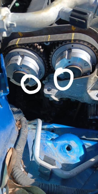

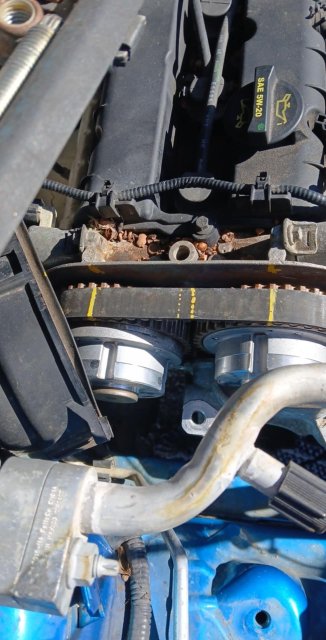

I recently did a water pump replacement on a 2015 Ford fiesta. The first time everything went well started right up, but the shitty gasket I got with the pump happened to be slightly out of place and it leaked a little. So I got a new gasket, tore it all back apart and fixed it. For the timing, I did use a cam locking tool. But I had to take it off at one point, and the cam gear closest to the firewall shifted back from around 12-1oclock position to around 10. I ended up using my hand and manually twisted it back to 12-1 position as the other one , and proceeded putting everything back together. When I went to put tension on the belt there was a little slack in the opposite side of the tensioner pulley from under the cam gear towards the bottom crank. When I did put tension on it everything tightened back up nicely. I hand cranked it around about 3 times and the marks I made for 12oclock lined up perfectly I think. I put everything on, filled up with water went to start and it just keeps cranking no fire. Any help would be appreciated. Also tips on the stretch belt would be helpful. It is a pain even with the tool and I've mangled the belt with zip ties Everytime. It would be preferred if I didn't have to take the cam cover off. So once again, any help is appreciated to get my car back running again.

I have it all apart right now, I hand cranked the motor a few times and both cams on top line up perfectly. So I don't know what the issue is. I read that if the timings messed up somehow not to keep cranking as it can bend rods and ruin the engine. I never pulled any wiring harnesses or fuses to do the job no electrical at all besides the alternator. So I don't know what the issue is. The battery died halfway through the job as well. I can't see anything that's visibly wrong with it although I'm not a professional. I read online also that the bottom crank pulley could go out of top dead center and not line up with the cams but I never cranked it while the timing belt is off. So I have no idea what to do at this point.

So I stuck a screwdriver i spark plug cylinder hole #1 till it was all the way up cranking the crankshaft, and once it was at top dead center the 2 top cams were both at around 11:00 instead of my original 12:00 marks. So I think my crankshaft and my cams are out of time. Hopefully I didn't bend any valves trying to start it last time I got it together.

OK! To know it sputtered gives me hope too!
As far as I can tell, the issue may have been from the advance in the cams, those bigger gears located to the front - were not completely empty when you started this project - the system uses those solenoids so if the system pressurizes the cams advance with oil - that changes the aspect of the systems advance - so you caught this early and knowing the advance timing of the cams and the piston aspect, you should be OK, else you would have heard loud clanging from the starter trying to kick it over - and in some instances the starter would "STOP" and smoke itself from the inability to move the crank from the jam of a valve advanced too far and it struck the piston - only under horsepower can the system truly bend a rod or break a valve to cause that condition.
Just reset the cam belt - pull the battery to reset the codes and try this again.
