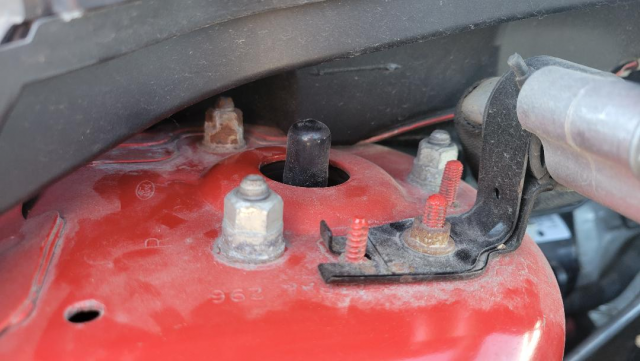

wondering most likely and obviously these are the mounting 1657386581448.png g bolt that hold the top of the strut in ? Thanks.
1,902
Yes. Those are the strut mount nuts. They are 15mm. If you are not familiar with changing mcpherson struts, i would suggest that you have a shop do that for you.

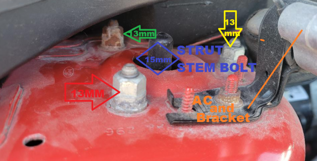

You have to lift the car and those 3 bolts on the PAINTED part of the Chassis side of the mount, use 13nn Anchor nut.
They are a special LONG (height - wise) bolt but if needed you can use KEPP or Serrated nuts if needed, Grade 8 hardened or higher grade.
The strut top mounts look like this...
1657421338780.png Hopefully yours are in better shape than mine

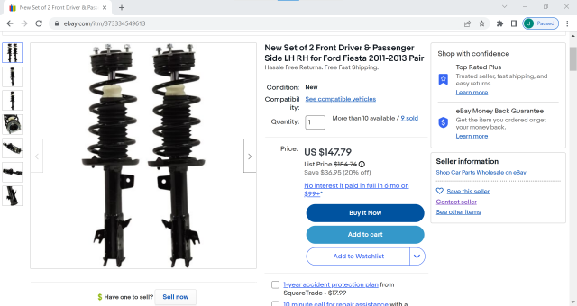

59
14
Rapid City
SD
2013 SE Ford Fiest 4 door Hatchback
These ? Also since they are already put together now in my car I can remove them and not have to worry about accidently killing myself from doing so and thank you for that stern warning.
To remove the "strut assembly" (the whole shock and coil) - you won't get killed if you just undo the 3 TOP bolts (not that bigger center one) and using a pair of long handled socket wrenches (18mm being one "odd size") you can remove the lower two bolts the hold the strut to the steering knuckle.
There are two other things you'll need to remove, the drag link (sway bar link) and the wiring clips that hold the speed and ABS sensors to the strut thru clips.
And the Brake caliper - hung on a hook so it doesn't pull on it's hose - so you can even remove the strut.
But to save the headaches of broken or stripped bolts - use new bolts during the install you can get when you buy the strut package.

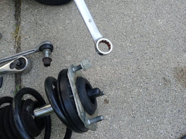

1,902
#14

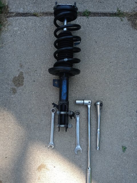

Don't completely unbolt the strut mount. Thats the last step. 20220712_093903.jpg

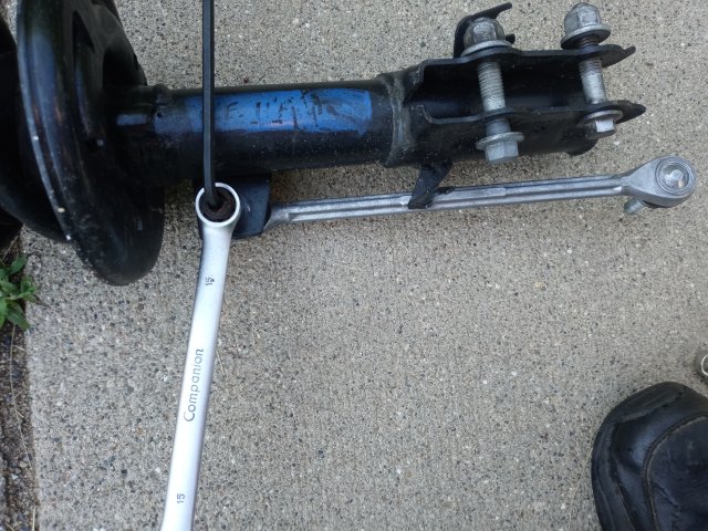

You will want to get the anti sway bar link loose first. If it's original equipment, it should have a 15 M nyloc nut. You will also want to have a 6 m allen wrench to hold the shank still or better yet, a mid sized pair of curved jaw vise grip pliars. It would be worth it to wire brush the threads and spray some penetrant on that one. It is often a tough nut to turn off. 20220712_093733.jpg
Then you can take that wire brush to the two pinch bolts for the strut to knuckle connection.

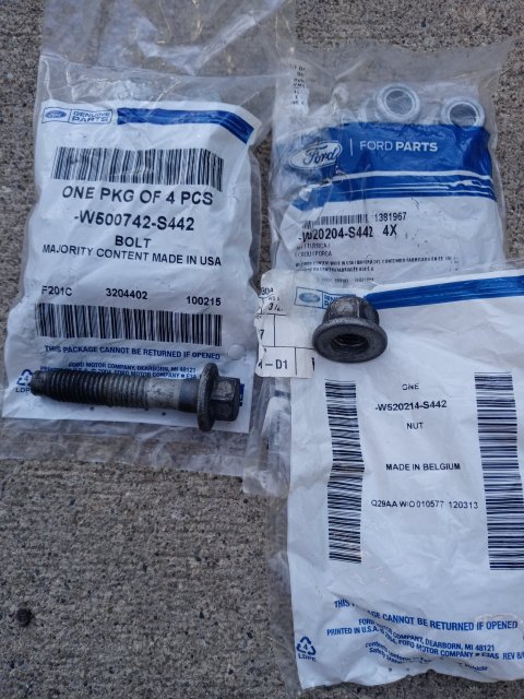

These are not reusable bolts and nuts. The bolt head is 15M and the nut is an 18M.
If im not using an impact wrench, i like to put a 15M wrench on the bolt head and then the 18M socket on the breaker bar for leverage to get the nut loose.
The lower strut pinch bolts and nuts are available from a Ford dealer parts department. These are critical bolts, but not really expensive. 20220712_091246.jpg
