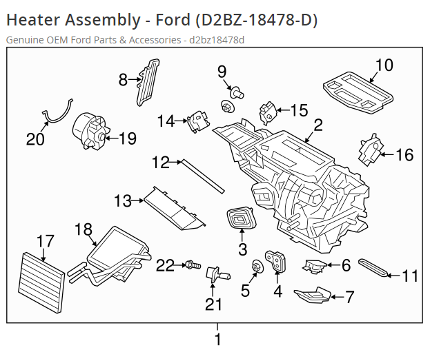

The core slides into that gap, with the hose tubes going to the front firewall/bulkhead - did you manage to save the original seals? Because those seals are what helps hold this core while you center and fasten it.
See number 5 in the graphic? That mates with the seal #4 - the tubes slide thru those holes - #18 them bolts to the housing with a few screws - you have a seal on the unit itself - thats ok, the seals I'm referring in #5 and #4 are the ones that go where that lights' shining in...

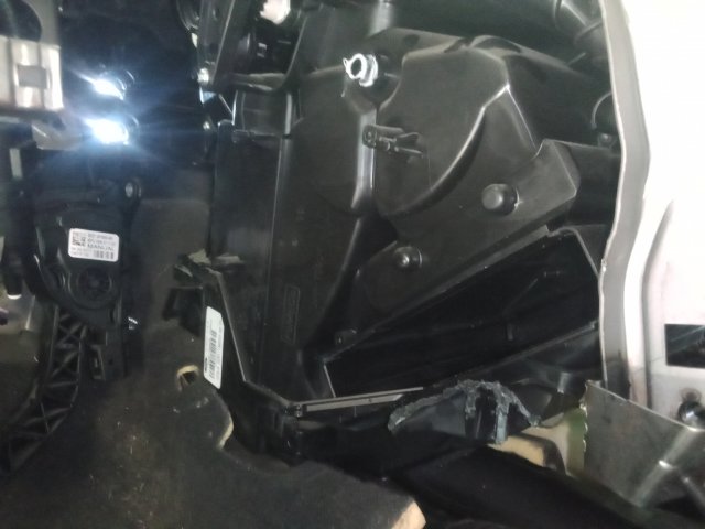

What's up with that torn plastic?
It's obvious they tore it apart.

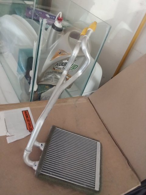

that was me that cut the plastic off at the bottom, the length of the hoses makes it to where the box part of the heater core is way up high,
the plastic piece was chewing up my new coils on the new heater core.

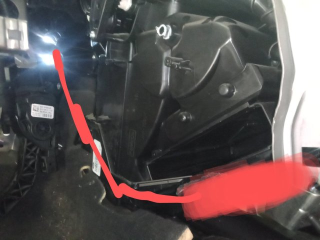

heres a illustration of how far out the alignment of the heater core lines go and where the other end of the assembly falls.
What I'll attempt today is to remove the rubber sealing (if its loose, i'll try not to break anything else)
to see if this gives me enough allowance to rotate the bottom half of the assembly back into its designated spot
