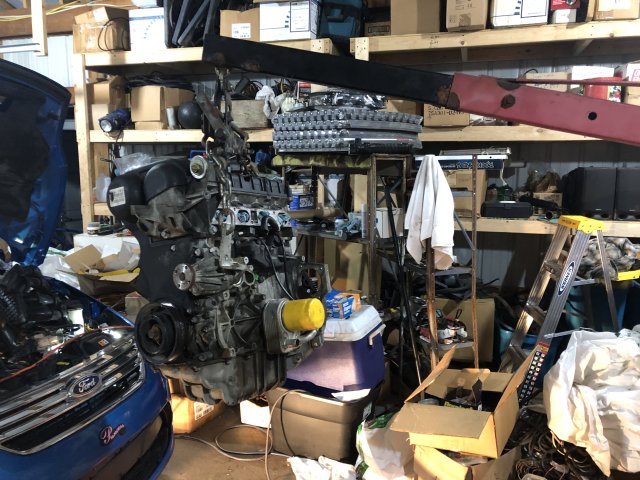

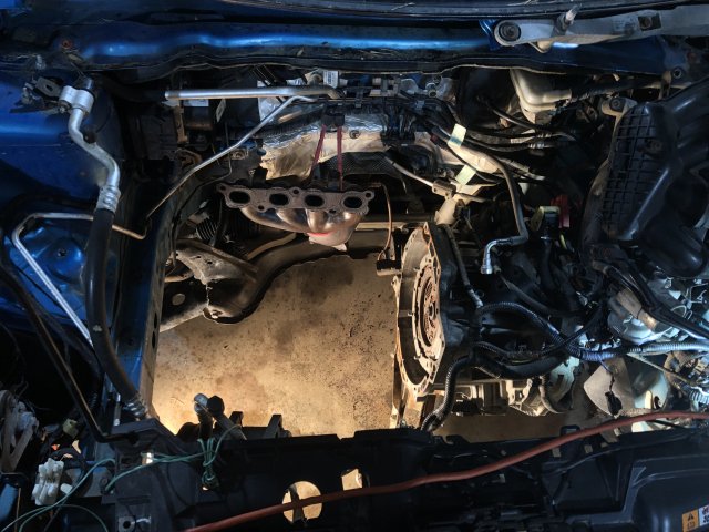

Engine is out. It’s in the garage, which is normally the home of my show car. Took me 12 hours yesterday, about typical. Hood stayed in place. I removed the passenger axle to keep it from getting overextended or damaged. I just popped out the balljoint since I just did those last winter anyway.
Only thing that broke was the starter solenoid, which would have broken regardless. Trigger wire nut was so tight it took 2 stacked vise grips plus wrench to remove the nut from the terminal. Can’t believe how much starters are for this thing.

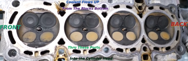

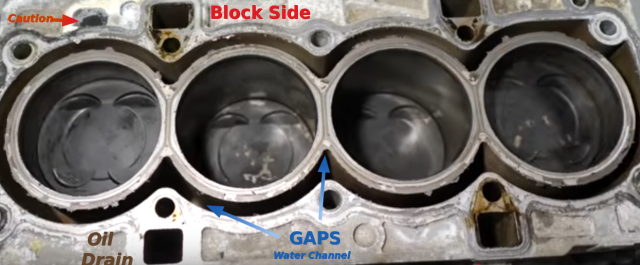

The engine block and the head need to be checked for warpage - else you may not be able to reassemble it right once the new gasket of this original motor has been changed.
When you remove the head, you'll see that the cylinders appear to "float" in the block when you look from the top-side down. The block itself is merely a container for the waterjacket the upper cylinders have around them. This is how the motor even works - the fluid carries the heat away while the sleeves transfer heat from their chambers. The Gasket itself is adjunct - which keeps the cylinders from bleeding - blowing into each other - but there are areas of concern where there are gaps in the joiners - the cylinder to cylinder sleeves - that let fluid in to cool that section. If these get caked with debris, the effort to restore it may be pointless for they may have developed minor cracks and will fail soon enough - meaning replacing the gasket is only buying time. As to - how much time? Depends on how much the gap is plugged from debris or caked with sludge from the radiator fluid and oil mix.
The Cylinder head receives the fluid and pushes it out the outlets in the back.
So gotta' keep the ports clean so if you decide to change the gasket - make sure those areas are clear of debris and old oil.
Have to add this in, because you also asked about the "Camshaft cap bolts" torque specs, they run about 92 to 95ft/lbs which may seem high, it is supposed to be...
Think of the geometry - the head floats above the block - the cams are integrated (bolted and journaled) into the head.
When the head takes on extra air and charge - the head itself can deform due to the combustion - so the deformation also can affect the journal to bearing clearances - people have had their head caps crack due to the out of round condition that can happen when the cylinder head gasket goes awry as well as lose camshafts due to the head warpage.

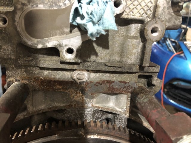

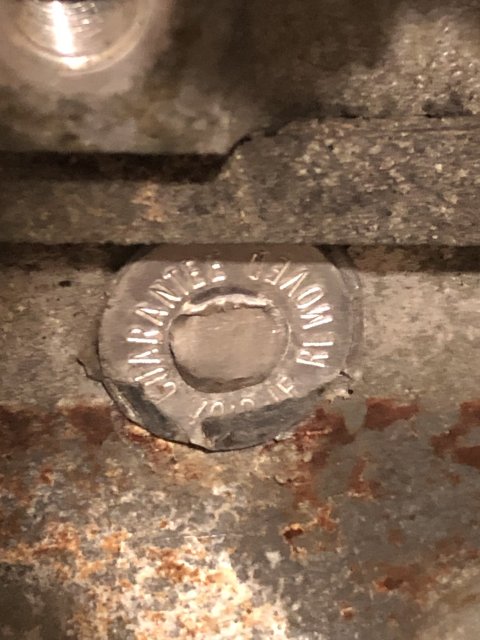

One thing I noticed that isn’t on the old engine, is what looks like a snapped off stainless bolt at the top center of the block, between the two top bell housing bolt holes, with a little sealant. Around it in a circle is stamped “guaranteed, void if removed” or something like that. Maybe this one was a reman at some point? I can get a picture tomorrow.

Here’s a pic of that weird plug thing, and another to show the location.
