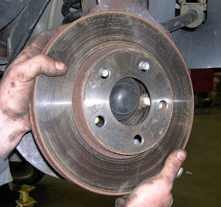

You also have the front disc brakes dust shields - and their clearance to the rotor might make the sound you describe, but only in heavy steering and moving.

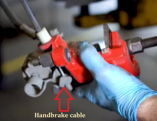

The rear brakes also have caliper and the bracket - but they also have levers for the handbrakes or for the E-brake (Parking brake) which can cause noises - first thing in the morning and when not driven enough - the rust accumulates and can bubble forth in a fashion where the hub/rotor combo and the pads own clearance - tends to drag - making a weird scraping sound (best way to describe it) like you have bad or too thin of pads on the rotors and they're scraping metal.

Rear wheel has rotor and handbrake and a close clearance bracket on the inner towards the hub - which can make scraping sounds when it has not been driven much and low-miles usually kills the brakes due to the rust, reduction and oxides that form on the rotors that the pads have to grind away as you drive,
If you don't drive highways speeds often enough to re-polish that surface...
They may need to be replaced or turned to make them true again.​
Some surface rust is ok, but deep cuts from the pads covering a spot on the rotor while sitting and the open air and elements getting at the rest of the rotor surface can generate an uneven wear pattern causing you to have no choice but to have a shop check runout and turn the rotors to make them true - else a strumming and shimmy - even a pulsation in the pedal - can be felt from this out of plumb condition. It's simply a divot.
Still a little vague here, but pull off the wheel and look at the brake to dust shield / caliper brackets clearance...
