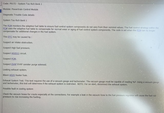

I’ve attached an image from Forscan DTC.
My suspicions now are to do with Fuel system, either injectors, rail or fuel pressure regulator?
