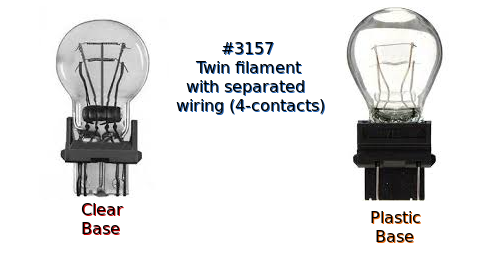

  • Depending on the year and the country it was sold in...the bulbs used can vary - for age and the year, let alone the availability to stock the right lamps to be used for the country they are used in...can range from older lamp styles to more complex ones
Here is an example...
There may be also different type of the SAME bulb but mate to a different socket​
This poses a problem with the wiring and the bulbs to remain connected for their lifetime - and even when they are changed - will also encounter the same problems of making good contacts for that next lifetime of use.

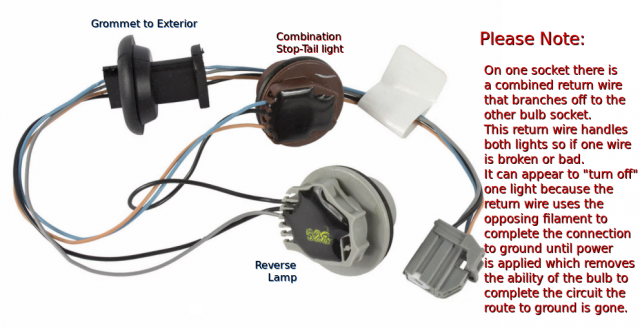

  • Both ends? OK, remember those bulbs above? They have contacts to the filaments - each filament can be treated as it's own circuit - so 4 contacts make two circuits (one in, the other is the out, makes 2-pairs) these contacts also can be tied together outside of the bulb and reduce wire count - so they call this combining a type of splice or joint. for electrons to pass thru and produce work. (Your light)

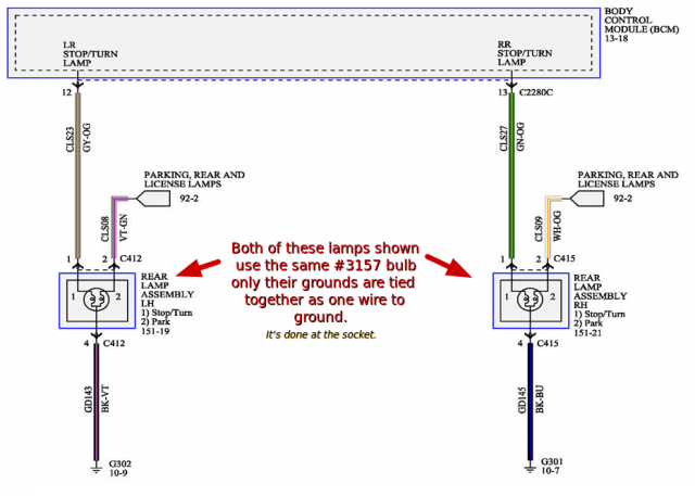

  • So the bulbs are fed power thru two different wires one functions as stop light (Brake) while the other works like your running light or Tail-light.

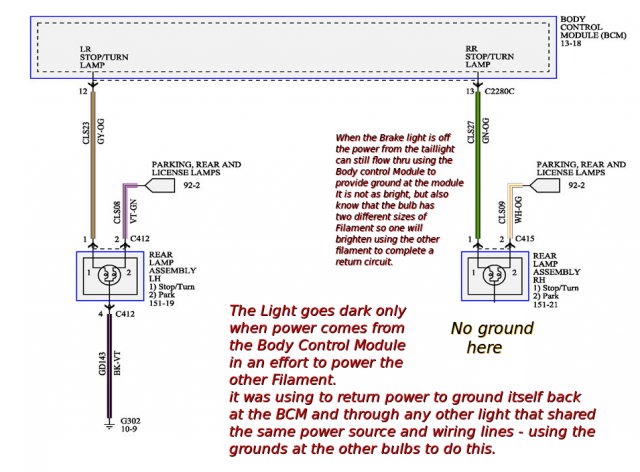

  • When the grounds are open - as in there is no return to complete the circuit at the lamp...the lamp can still use the other lamps tied to this same circuit from the Body control Module to let power flow into ground using those other filaments the others bulbs have - as wires in and thru to ground at those other bulbs.
The Light goes out because there is no difference in voltage in the bulbs contacts and the wire now, so no power flows - it's static, meaning it's power doesn't go anywhere. The bulb goes dark because of the loss of potential difference in the wire it was using to find ground thru those other filaments using those other bulbs that were not lit - is now powered at the same power level the other filament is in that bulb - so it's like there's no power flow. It's caused by that loss of difference - even though power is able to be applied - it can't do anything - it just sits there so the filament can't light up.
  • - their filaments when cold work like short circuits - when they are heated - they provide work and increase their resistive impedance in the circuit preventing them from letting all that power from the bulb missing it's ground to flow thru them.
  • - therefore letting power flow thru them when not powered lets that other filament of that one bad bulb still find a way to ground and produces light (work) because of the other cold filaments are acting like dead shorts to take up that leaking power.
  • - if you have enough bulbs in the same circuit - they will act like the dead short for the no-ground that bulb had and those others will remain dark even though power flows thru them - there is not enough power from the filament to power all those bulbs to lite up but the other bulbs provide the return to ground because their filaments help complete that circuit the bad bulb needed to work it's filament - the load across the bulbs help with ohms law in resistance in parallel - each resistor or element sees less power because the power flowing thru the circuit is reduced by the number of elements in parallel in the circuit to carry that power across themselves.
  • - as the ground for that bulb working like the ground for that no-ground bulb - the power flowing thru the wires to those bulbs is reversed - so when the wire is powered from a different source (the cars brake light wire not the bad bulbs filaments) the light goes out because the wire now powers all the bulbs and swamps out the current flowing from the bad bulb so it (that bad bulb) goes dark - due to that bad bulb's filaments can't see any difference.
  • Remember too: The type of bulb used can make understanding the power flow thru the wiring more complex. As for; The wires on a Bayonet-style bulb are three point contact - one set of the wires for BOTH Filaments are tied together to form one contact point and connection to (in this case) ground return - In The Metal Base of the Bulb.
  • In the "Square Plastic - Style" connector the base has all four wires used and are kept separate in connection. However, only the bonding point which ties BOTH Filaments together is done At The Socket - Not At The Bulb itself as you'd find in a Bayonet-style bulb. So it's grounding connections are wired to the correct contacts - inside - the socket itself.

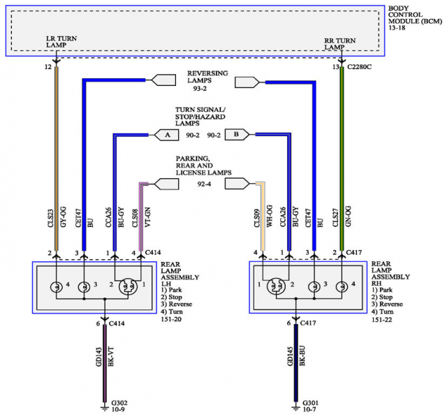

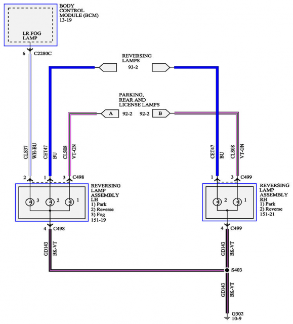

For a 5-door (hatchback)...has a 5-wire (function) system Left Turn,Right Turn, Stop, Tail (Running light) and Reverse (Backup)
Or another way...
Some 4-door sedans use this scheme (shown below) - a 4-wire (Function) COMBINATION light - meaning that the Brake and Turn are the SAME bulb so when you use the brakes, they both light up, but when you use the turn signal - on that side, the brake light only flashes - does not stay on, for that side - meaning it's a combination - so the other opposite side brake light and the third brake light high-mount stop lamp - does "the show" to let drivers behind you see your intent. IF you live in the UK or EU some countries require the use of a rear "fog" light as a marker light to help others see you.

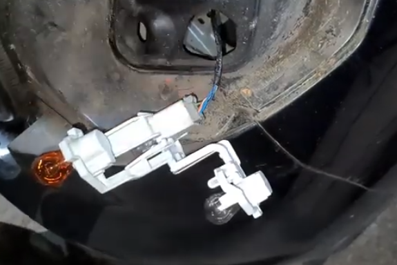

Make sure the bulb is inserted into the socket all the way, fully seated. May need to have someone to press on the brake pedal while you have the bulb and socket out so you can wiggle and press the bulb into the socket to observe any interruptions or intermittent operation - if you see that type of condition, you will need to investigate further.
Sadly heat causes the plastic in the socket to deform and due to the metal contacts and their spring tension, they may lose contact over time, this is a common problem that requires replacement of the socket and install a new pigtail, which is a more dedicated service and repair. Yes - you can do it but the effort requires some tools and skills many don't have.
Otherwise, you will have to check the pigtail-connector that connects both sides the left and right at the branch for the lights and it's inside the cars trunk - by the Left rear tail-light.
It can be the above, or something more exotic like a pre-molded base socket and connector assembly that fits the tail-light
