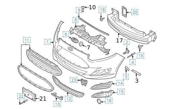

Go here...
https://www.lascoautoparts.com/v-2018-ford-fiesta--se--1-6l-l4-gas/body--bumper-and-components-front

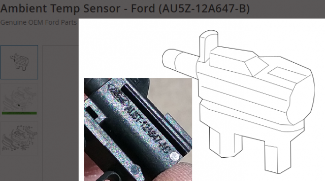

Look for part #26 - Ambient Temperature sensor. - if you live in the US this sensor is similar for many of their model years.
They may have nicked the wiring or even removed the sensor to obtain access - it's easy enough to bump off and it may have fallen out of it's holster.
IF you can view the graphic on that link, the sensor itself is by the air intake snorkel to the front grille section. IF they had to remove a part of that to get at the air cleaner - they may have pulled the plug out of the unit - hopefully it is still there and you can just replug it in.
