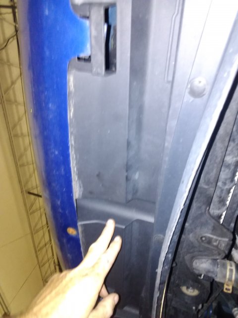

I think you will have to remove the lower valance panel. It's held in place by push pins. Most people would probably describe it as a "filler panel" between the radiator core support and the lower front edge of the bumper cover.
I have my Fiesta on a hoist for maintenance now. I will look at it to see what it will take to get access to the hood latch. I have never seen or experienced that problem with the Fiesta, yet. That's an interesting question!
This filler panel. The the air dam might have to be pulled off first. I had the bumper cover assembly removed many years ago and cannot remember the procedure. But removing the panel will give you the easiest path to reach up and snag the release lever. IMG_20200808_110251.jpg
