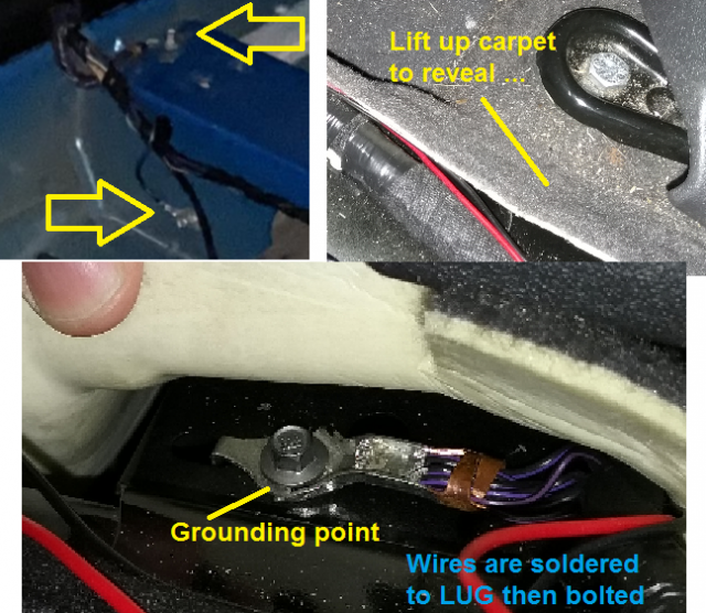

This may be more of locating the ground return bolts under the carpet.
IT's a 2006 so it's not out of the question that some of the wires can have corroded off the grounding bond point.
