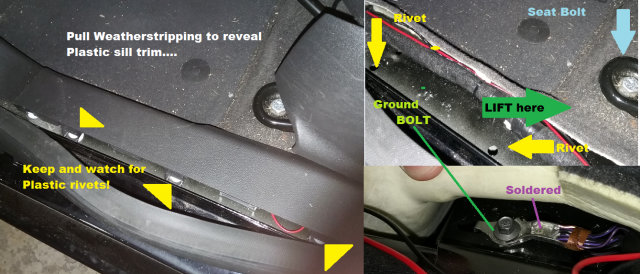

There are two - one on the Drivers side, the other on the passenger side.
Both use a BOLT into the frame cross member that also BOLTS the seats to the floor.
So to find it, you pull the weather-strip on the floor sill, to help you get access to pry up that plastic trim - once you have the trim remove lift up the carpet - it's right there.
Both sides need to be checked and as needed cleaned and reseated, and on my 2018 - is bundle of wires Black Violet/Purple Stripe as the major ones, are SOLDERED into a lug and bolted to the frame.
  • now if it were me, I'd get a little propane torch and solder, and reheat, reflow solder and replace the lug back onto the bolt, using a copper based lubricant - ones that work for anti-seize compound and or battery terminals. Worth the investment if you can take the time to DIY ground connections.
You don't have to remove any seats or extra trim - just examine and if needed - clean it up from rust and debris - and re-oil-lube/retighten the bolt to seat the connection back to frame.
Those under seat grounds will be a growing issue. The odds of windows being left down in rain storms and all the tracked in moisture of normal use, along with the occasional spilled soft drink or partially drunk Gatorade bottle that will get kicked under the seat with a loose cap that will help speed up the corrosion. Not that i have ever seen that sort of thing occur! (Im lying. I have)

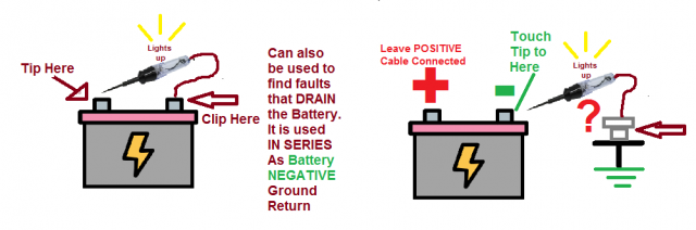

In light of the Alternator, I wonder if you have a simple tool that I found - beats any moneymaker YT or any person trying to take advantage of others that are desperate for ideas on fixing their car and finding low-cost methods to avoid getting stuck with big repair bills...
Got a Electrical Tester?
Like this
Because it also can be installed from the Battery Positive Terminal - to the Ground Bolt that the Battery Ground cable goes to...
Why? Because you can look for SHORTS, as well as ACTIVE circuits...
Then Why Filament? Like a Flashlight?
Yes. Because there will be times where a LOAD is needed to be placed across the system, to drain the capacitors and extra stored energy when you need to reset the PCM or even the BCM due to a fault that got fixed, but the system needs to drain itself so it can "boot" from it's OEM and "Learn" your new fixed system all over again - a form of training the PCM and BCM to start talking to one anther and learn each others habits. A simple Flashlight bulb of the older Filament.
How is that done?
See the Clip? That clip bites into attaches to the Ground Bolt on the car, you can then place the testers probe lead into the Positive terminal using the Post to terminal clamp "gap" to hold the tip.
Bury it, stick it in - firmly into the gap between the positive post and the bolted clamp and note the light is now on - now disconnect the Battery Negative post clamp and the light will go out - the Filament has taken all the STORED energy thru itself - into Ground as a Short - the Bulb will light when there's plenty of power from the Battery.
But when you pull the Ground cable - the stored energy flows thru the bulb and to ground. The circuit provides a means to drain the systems own power to ground thru this circuit - the tester uses the standard filament bulb to light, but the bulb itself is wire - so it too can act like a dead short. This drains the system - leave it in this state for 10 minutes to ensure the reset is complete. Reconnect the Ground cable to the Battery post, the tester will light up and you can remove the tester from the post and ground bolt - RESET complete.
The Filament is a wire - a piece of metal (Tungsten/Nichrome) that heats up and glows brightly when power flows thru it. A wire can pass any power thru itself - the Filament being metal like wire - can also pass power thru itself. When power flows thru this filament - it starts to heat up because is has a small amount of resistance when the wire is cold - heating causes it to exhibit a resistance to the flow of power and it exhibits an increasing resistance to the flow of power thru it. It is an electrical short - much like a fuse, but controlled, by the type of metal wire used as the filament. It will light - getting brighter until it too passes a point of too much power and the filament opens - just like a fuse.​
Otherwise it looks like a dead short for any lower voltage and current - it will still flow thru it, just there's not enough power in the trickle charges left passing thru it to light the bulb but still allows power thru it and looks like a dead short.​
This is how you can reset the system and drain off the Non-volatile Memory - forcing a reset. Apply a short across the terminals - using the filament of the bulb of the tester to provide the short - you use the tip to one and the clip to the other terminal you make a circuit complete - it will consume all the power within it. This drop causes the memory to be erased - reset to "0". .When you reconnect the battery to supply power - the memory of previous operations and performance, emissions and control states are lost, emptied, removed - you start over.​
Now you can also use it to determine is power drain is thru a charging system issue or you have an accessory still using - pulling power from the battery - you can do the same test only instead of placing the leads across the battery - you use the Tester as a CONDUCTOR - like the Ground Cable it takes place of it - power losses will light the bulb.
Here's an Example
  • - to find out if you have a power drain

  • Go back to the Battery Post Ground cable - loosen it but don't pull yet, allow the engine to POWER Down - reset the fuel injectors and seat the throttle - all the stuff it needs to do to power itself down.
  • When it's quiet (the engine) now reach for the Ground Cable and pull it - AT THE SAME TIME - attach the Tester to the Battery Post with it's Clip to ground bolt.
  • - you attach the Tester tip to the NEGATIVE POST POST of the Battery - the Circuit Tester completes the Circuit, acting as what the Ground Cable does.
  • - The Clip goes to the ground bolt - and tip to Negative terminal - then loosen the Battery Clamp and pull the Ground cable .
Now, the moment of truth - When the Battery Cable is removed from the Post, the TESTER becomes what that Cable did - does the Tester light? Ok if it does, give it a moment - leave it in this state for several minutes.
Does the light stay on? Then your answer is YES, it's some kind of Electrical fault in the system - you DO have a power drain in the system.
Might need to have the Alternator rechecked. It may be a Diode in the Alternator - or a A/C relay not clicking off.

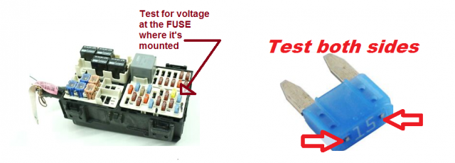

So you may need to see if the Fuses can receive power - like they should - or receive power when they should not. A Circuit Tester can help with this.
The Tester "clip" is clipped to the Ground Bolt, or known frame bolt of/For/To ground if you have to check the BCM (inside car).
The Tip of the probe only has to touch the "tip" of the fuse metal exposed at the number of the amps the fuse is...
Test both sides!
If the Tester lights on both sides
the FUSE is POWERED and still GOOD
But should it get power ALL the Time?
Read the Owners Manuals ' section on Fuse, their location and function.
If there is power flowing into the Fuse, it will light the Lamp - the Tester lights because it is connected across the power source and to the Ground point you clipped to.
That is where your owners manual comes in, you will have to find the circuit it is assigned to and can help troubleshoot the problem.
