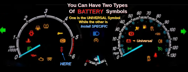

You now show a "Battery" - you may have two types of symbols, one that looks like a cartoon battery...another is a schematical representation, and you will see both on startup.
If you had to have any type of Handicapped assist equipment installed or bought it used and have no idea what the History is - the below can help you.
Like this...
The above is pretty much what you'd find in the PODS on the car.
If you have the UNIVERSAL symbol then that light represents a problem with communication from the SYNC unit needing a power feed from the Battery to keep itself alive and functioning. Since you did have Bluetooth at one time, now you don't - this may mean you need service or you just have to find the Fuse that controls the SYNC side of the Audio Interface Module.
The Body Control Module may also kick on the Battery light because a feeder or the Fuse to it's interface that lets SYNC display messages using the Main Console has blown - you seem to have Radio - just no Bluetooth so the APIM (Accessory Protocol Interface Module which looks for all the stuff still connected - just isn't seeing it.
