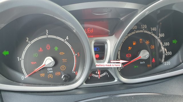

How does this work on this car, EU model from Netherland, have seen this battery light under km needle which never turns on?
Even from Secret Dash mode test all lights turns on except battery light.
This seems to be the cause, the light for it is either broken or blacked out.

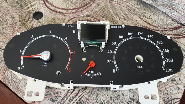

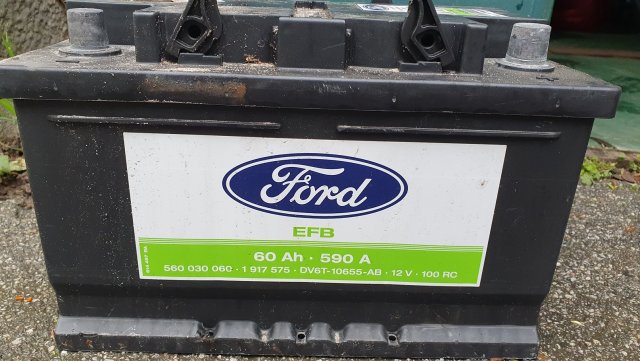

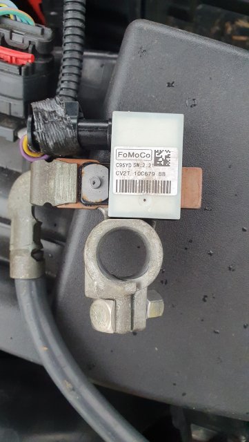

Below are pictures of my dash, BMS and battery.
Battery is OEM Ford for this car EFB battery good condition, proper SOC and SOH after DTC U0120 repair. No issues during cranking, start/stop works fine now.
BMS has 2 wires, violet is LIN and Yellow is 12V from +battery pole going through 3A fuse and this voltage comes to BMS connector.
BTW not sure how to reset BMS as from Forscan for my BCM I dont have this option, doing some other tricks by pressing buttons/flashlights etc does not show any results as I dont have battery light to see it flashing as confirmation for BMS reset.

Have you replaced the Alternator?
The issue looks to be more of the LIN wire - either opened or is not talking to the Generator to develop resources and profile so the system can charge the battery correctly and it is charging the correct battery for the system.
The OEM did make it so that once the idealized versions of the charging system failed, it would have a default mode of what a typical charging system would do, being 13.8 to maybe 14.1 volts which is safe for the vehicle and the battery but not idealized for the system.

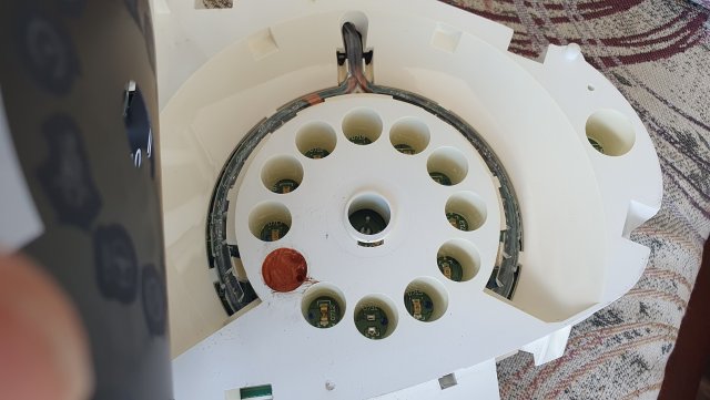

Issue resolved. I suspected that somebody did some stupidity on cluster itself and there it is. He put silicone into the hole where battery led resides and completely glued and covered SMD LED.
It was hard to remove all silicone without damaging led itself, but I managed to do it carefully.
