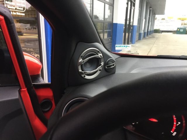

the mids and tweeters are going on the dash in that useless window spot. ill have to run new wires to the t-harness.

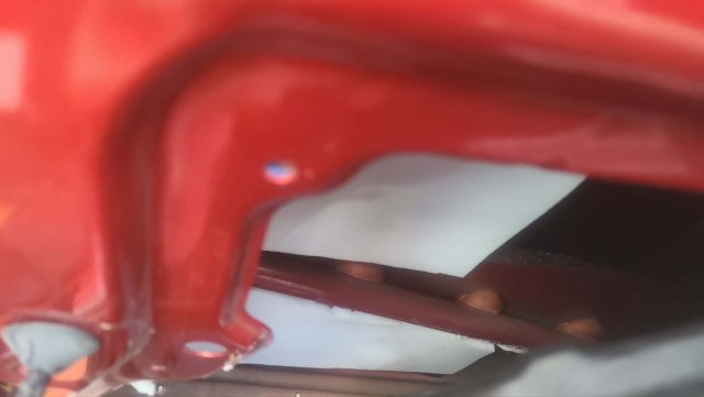

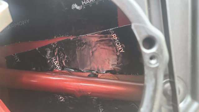

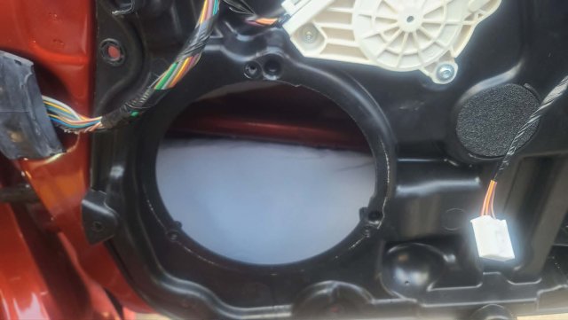

the sound dampening is important helps stops the rattles and buzzes. the foam stops the back wave and improves the sound of the speaker as well as does some sound proofing from external road noise. use the wrong CLD and waste money and time. use none hydrophobic stuff inside doors mold and fungus and mildew happens. the deadening on facebook.
the doors have cld and hydrophobic melamine foam.

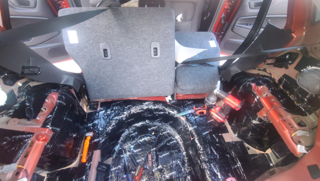

the rear cargo area is cld with some heat wave jute 1/2 because thats all that i could fit. i wanted more though.

i did not take the inner plastic card off. i worked through the speaker hole and the edges. took all the bolts off pried the side back a couple of inches carefully since if you break something its a waiting list to get replacements.
these are the type of mids,tweet pods am having made.
i did the cargo area last night and will finish the hatch tonight.

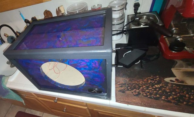

the sub box is being made by AudioArte on facebook. he uses baltic birch. this is the one i had made for my other daughters HRv. the daughter with the fiesta is getting the same style and size just a different color.
