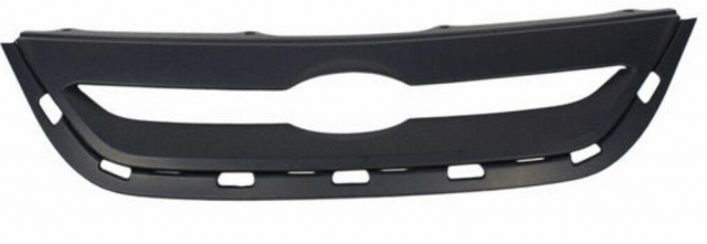

They raised the height of the crash absorber part, so we don't have a "Full Grille" as if it were the earlier models. Instead, we have the "Grille", but it is missing the bottom half of the ventilation it's blackout trim - it covers up the crash brace.

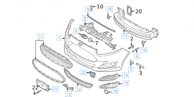

Totally redesigned - #17 is that adapted Crash Member

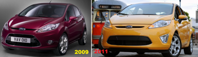

Here's a Side By Side...
The hood made a "seamless" mesh with the front piece in 2009 - but in 2011 - they went with an Insert - with the Hood still same shape and meets in the same area - but the bumper/crash members were changed during these production years. Round Fogs were replaced with Triangular inserts - which they reverted back to rounds in 2013 more in line with Ford Focus rounds with "cutout" trim - to name just a couple - but either way, the "Bumper skirt" is different - and the Hood's "Notch for the Emblem" is evident in the 09, but not in the 11' onwards.
