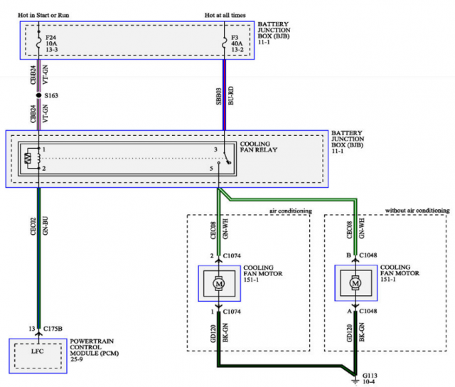

This thing is a complex mess, to start and just say replace this and that are just shots in the dark, so it sounds like everything that COULD be replaced - was - and no, it still doesn't work.
Let's see, you're getting responses thru the OBD scanner...
So it's trying to work, no cooling - one thing you did not mention I covered this in another thread in a Focus forum, that the "expansion" nozzle - the one that does the constriction to get the refrigerant to "work it's magic" - wonder if that is shot.
You have pressure, but you didn't say you had high side and low side - by my own experience you need at least 7kPa to "start" the cooling (pressurize the switch) so it rises to about 15 to as much as 30kPa - but you also have a low side that is the RETURN (vacuum to compressor) side which is the lower, the dynamics between gives you the cooling and heat is exchanged. (so it may be too high in pressure - forcing it to shut down - bypass)

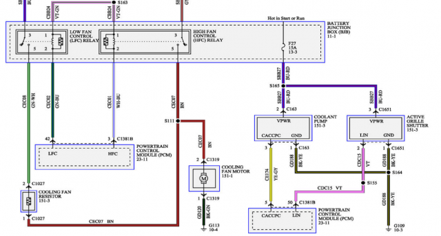

You might (again I don't have your vehicle in front of me) also have a fan resistor - low speed one - designed to make the fan quieter - so the "biggest test" is to see if overheat or above range - the radiator fan will kick on to cool the motor - but the low-speed resistor might have opened preventing the low-speed side to work.

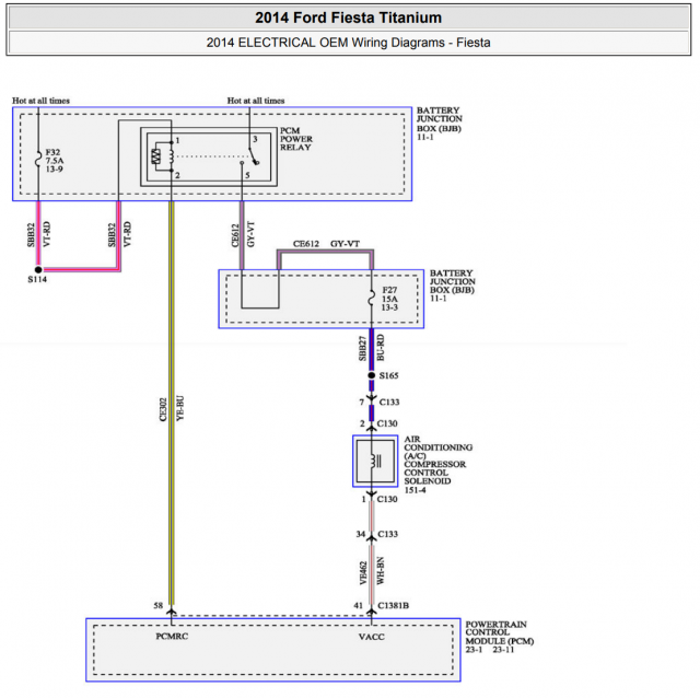

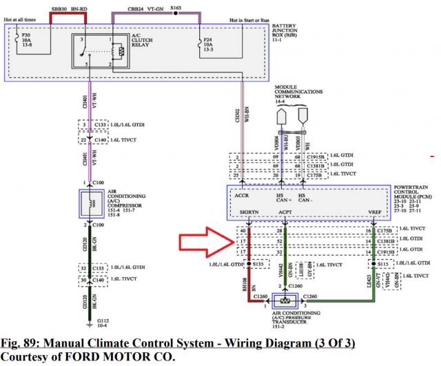

So if the clutch works...

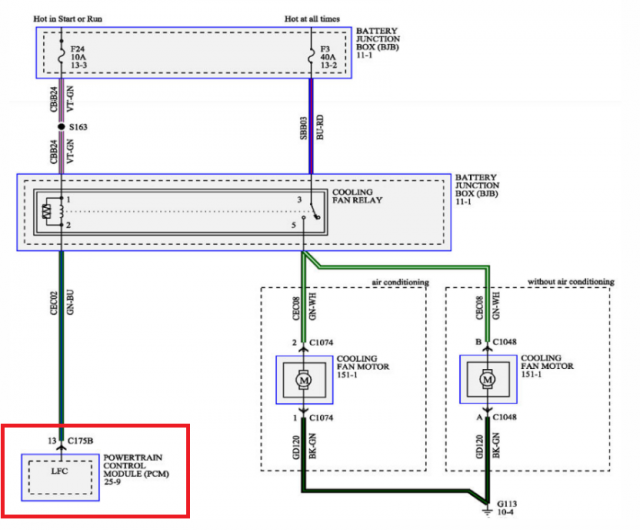

Back probe Pin 13 of the PCM - see if the PCM can work the relay (continuity) - if the Pin 13 line can be turned on (by grounding) that wire, then the issue seems to be with the PCM.
... or ...
I've seen accident vehicles have issues, some even as simple as a broken thermometer (air-temp sensor - open line) to check the temperature of the air - so something simple is getting in the way of all this.
Did you check that section of the relay/wiring mess?
