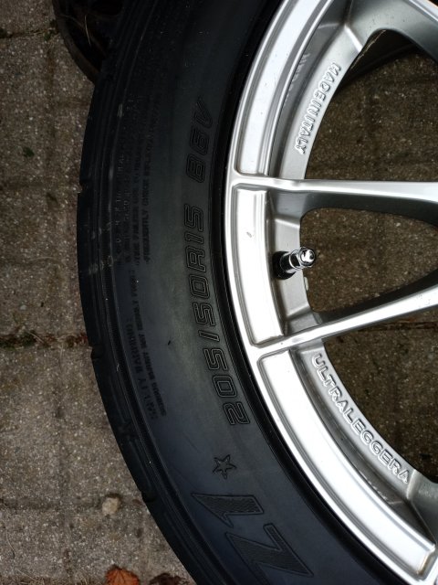

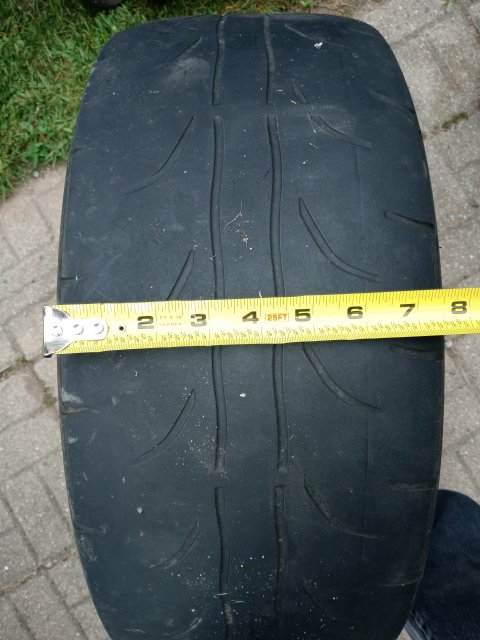

205/50 R15 Dunlop Direzza star spec. 20220906_183928.jpg 20220906_184034.jpg

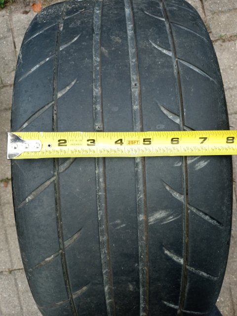

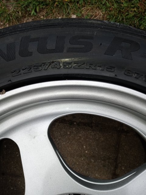

Then there was the 225/45 ZR15 Hankook Ventus RS3 20220906_183918.jpg

205/50 R15 and 225/45 ZR15 Hankook Ventus RS3
Dang. That is basically the same tire size. I'm honestly a bit shocked the stability control was intervening at such close margins. On your 2011?
